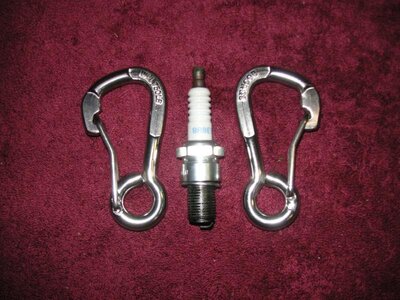

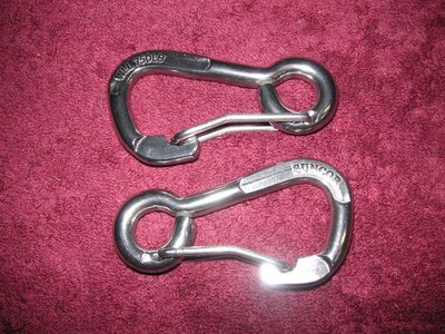

I was asked to post some pics of the clips that I use:
all stainless with no pins to rust

Those are sweet due to the seperate loop at the bottom for the rope. Carabiners seem to get dropped in the water since they fall off the rope. Plus the clip without the jagged edges will keep it from getting caught on the rope. Perfect design IMO. How much are you selling them for?
chris I need a pair of those next time I see you....those are way better than the ones I have now..
