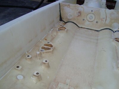

I'm leaning toward no foam in the rear. I plan on foaming the top and glassing that in much like Superjett did on his hull. I will reinforce the sides with carbon and grind the ribs down. Since I am not running a water box I might just use some vacuum bagging material and incase some foam in the nose of the ski. That should be more than enough to float the ski and IF it ever gets wet I can just swap it out w/ no cutting of the hull. There are so many areas in the rear that could leak..... and do..... that I would just like to plan for the worst. This will primarily be a flatwater hull so it should be fine.
I need adequate flotation for sure. If it goes down in the river I am smoked!!!

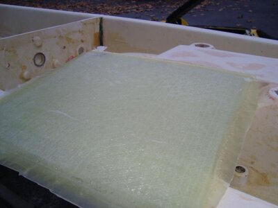

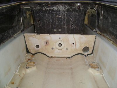

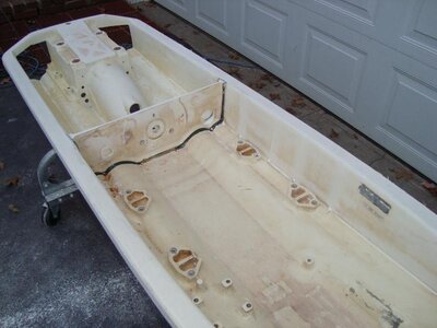

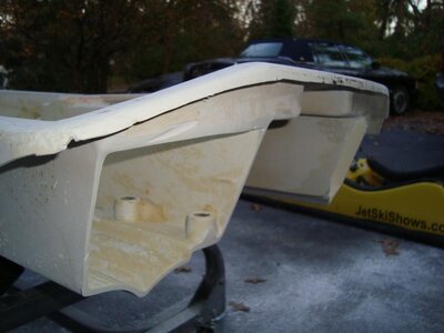

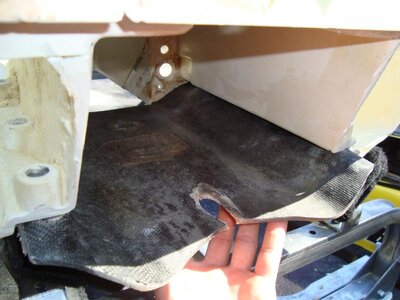

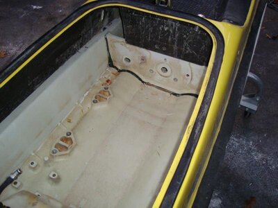

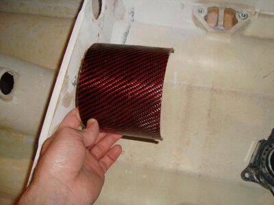

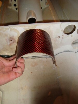

Did some more work today. Patched the ride plate and laid some carbon over the top, made a panel to enclose the rear sections of the hull, trimmed the bulkhead and ground down the ribs. I need to get the rest of the glue off of the top deck so it sits down flush on the bottom deck.
The battery will be installed in the bulkhead with a WDK fiberglass battery tray.

when you make ur upper bulkhead, make it either have a flange on it or lay some extra glass on the inner hull where it fits. Side landings will flex the side except for where the bulkhead is. If the bulkhead is too skinny it will crack infront and right behind the bulkhead on the upper deck. I found out the hard way

Im going to make a template and transfer it onto a pre-made glass panel. It will then be glassed to the upperdeck on both sides before I foam the top. When I put the top onto the bottom the bulkhead will be glassed at all the seams

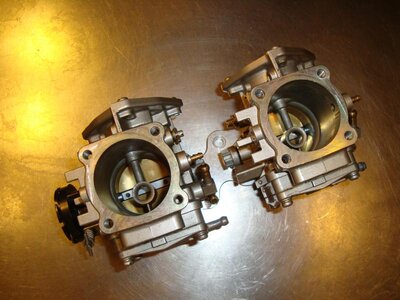

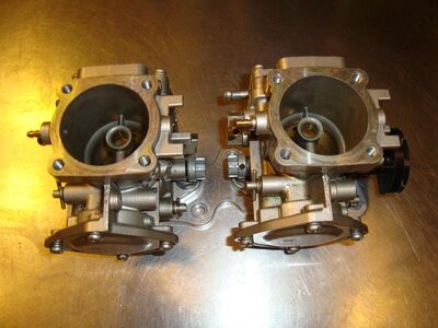

yes, sold the f1PRO, 66e w/ PFP exhaust, full spectrum carbs and other misc stuff. Used all that money to open my Roth IRA, establish a rainy day fund, and make scheduled repairs on my jeep. When I sold the full specs I used those funds to buy a set of sbn 46mm mikuni's, stock superjet pump and glassing material.

The thing I don't like about foam is sooner or later it will get wet. Then I have to tear the hull down to fix it. It will have foam, just not in the back. I don't want the headache of having that sort of down time anymore.
The engine will not be anything fancy either. Stock stroke Lamey pv with b-pipe, MSD enhancer and tbm flywheel. Switching from full spec 49's to SBN 46's w/ stock fuel pumps. I will loose some performance but the 49's were just a little too big IMO. The SBN 46's will make it idle better with the sacrifice of explosive midrange power. If I don't like them I still have a set of 48mm Powerbomb's I can throw on there.
