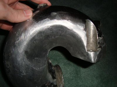

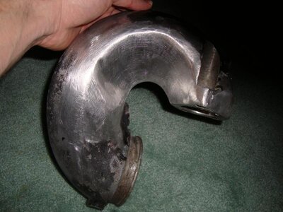

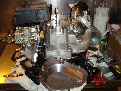

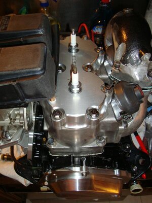

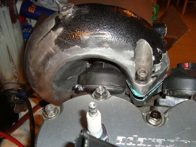

finished modifying the exhaust to clear the PV's. I still have some blending and painting to do. Other than attaching some hardware and rejetting the carb's it is almost ready to water test in the hull I am taking to Daytona.
