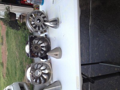

Not on the maxx pumps with maxx driveshafts. All of the maxx driveshafts i have seen use the std single row oem style bearings. Different than skat seback setup. I have a maxx shaft here from tricky for testing and we will be setting up josh's maxx pump with a mag shaft like skat with the dbl row bearing in front. In my opinion, the dbl row bearing is needed for stability when you move the bearings closer together.
so do i need another oem bearing or a different one to do the double row?
