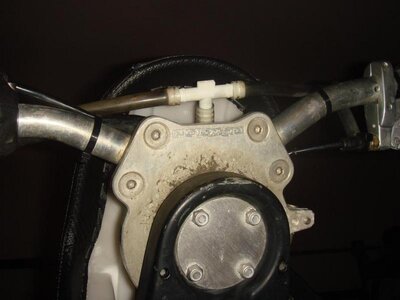

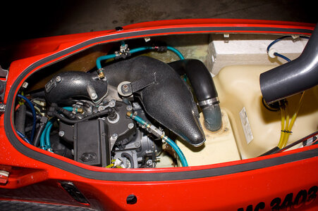

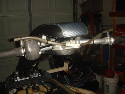

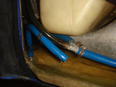

Here you go dude. All you need is about 10’of hose, a plastic “T” and a bunch of zip ties. Everyone does there’s different but I re-routed my pisser water up through the pole and across the bars to dump right on my knuckles. I’ve tried all different configurations and this way just seems to keep my whole hands warm. Use the zip ties to hold the hose exits right where you want them.

Good idea, I like that. Quick and easy to do. Thanks for the pics.

Thanks those are the pics I wanted. Without all the grief from these northerners :poke: hehe .
