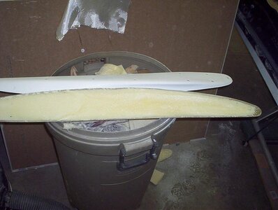

For now, didn't know Louie had them in the works, and for the price its just hard to beat. He did a nice job on the design, as they are pre curved and almost just lay down. They will need to be foamed on the back. Time is the one commodity we all seem to be short on.

I bought a set for my build (http://www.x-h2o.com/threads/29480 ) as well. Fit pretty good and the price was unbeatable.
Crab, how far down on the hull are you mounting yours? I did mine almost flush with the outer chine and now wondering if I should have left it up a little. Not sure how this is going to affect the handling (turning).

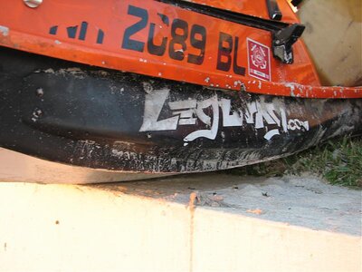

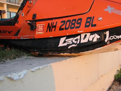

I plan to hold them down as well, here is a pic I took of Pete's just before we left on monday. They seem to have more flexibility as to where you can put them since they are made a bit different.

Yeah, I have mine much lower than that. I just found the best spot which followed the contour of the hull. The end is about 5" past the open footwell.

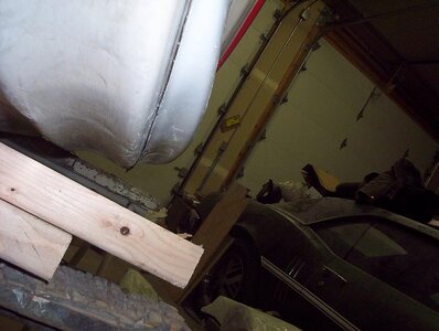

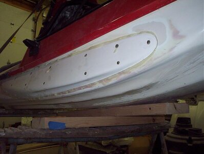

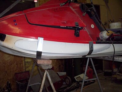

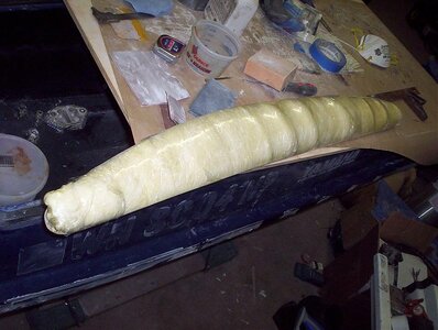

Step by step, foam, fit, epoxy thickened with cabosil, SS screws, remainder of epoxy thickened with fairing mix for putty while wet, tomorrow sand and paint.

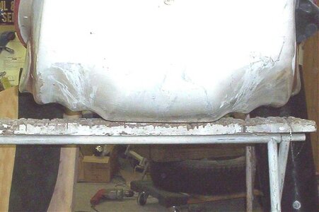

Last one, you can clearly see the reshaped hull and the added tubbies and why I held them up a bit.
