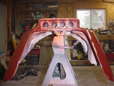

I don't post on here much but wanted to share my X2 build. I hope to be riding by April!
Below are just some of the highlight pictures. I'm currently working on the bottom right now and will be installig Tubbies soon.
Then the fun can start with putting this thing back together.
Well, I dragged the '87 X2 hull that was sitting in the woods behind my house for a couple years and began CHOPPING! I figured I would share my build with the rest of you X2 freaks.
Its a mess and looks like absolute hell right now but the final shape is starting to take place. Going to need to sand and fill a few more times......waiting on more epoxy resin at the moment.
Here's what's on the menu:
- Shaved hood and steering deck with custom air intake system. As seen in the pics I made a rear facing air scoop by molding around a Dole drinking cup
. To keep water out, I have a 2" PVC connection going straight down which will tee off (up high) to a 2" flex. The flex will be routed to the front of the ski and act as the intake. The other side of the tee will go straight down and 45 into the firewall and exit into the storage compartment under the seat. This will be my drain for any water that might get into the intake. What do ya think

I mocked up the fuel tank, waterbox and exhaust hose. Looks like its going to fit and work out pretty well.
The tank and 2" exhaust hose is from a Superjet SN & the waterbox is from a Superjet RN.
Still working on the body filler and shaping.......I think I'm almost done:scared1:
I have heat in my garage while I work but can't keep it on when I'm not in there so the epoxy filler is taking forever to cure. Takes about 48 hours with the fast hardener. The medium hardener was taking about 4 full days.

air intake
I hope your air intake doesn't spit water into your carbs...I see how you have it and it looks like it will work the only thing it is pointed @ the carbs...maybe piont it back or something...I have 4 tubes that run forwart to the front of the hood and stop about 4 in. before the front and just dump...Mine will hopefully not swallow too much...Great job...
