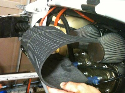

ive been running that hood for years with a crap hoodseal and havent had a problem...you can use a piece of rubber or laminate a few pieces of turf to make a flap to cover the intakes kinda like a scupper for the hood...

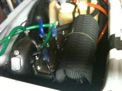

i dont have a wam hood but this very high tech device help me with water getting in my carbs on deep stabs and invert subs. turf with cord around it, stays in place and removes easy, ive seen some with the ends zip tied closed also
