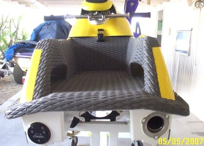

Good advice Wavedemon. I hate turfing too. Thats funny you mentioning ripping it off. My first side piece I did got jacked/stuck on and I ripped it off. Fortunately I made patterns for all the pieces.
Yes the heat gun, welding glove, and preforming/shaping is your friend for the front bumper and rear corners. Taking your time and not getting frustrated is make makes a nice turf job. Be patient!
