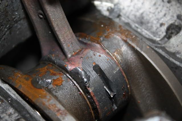

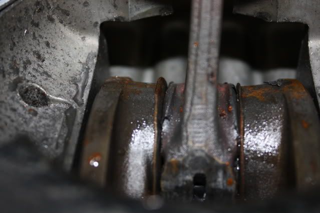

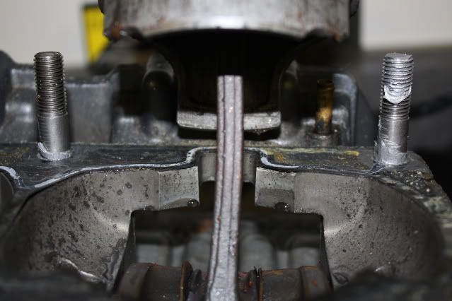

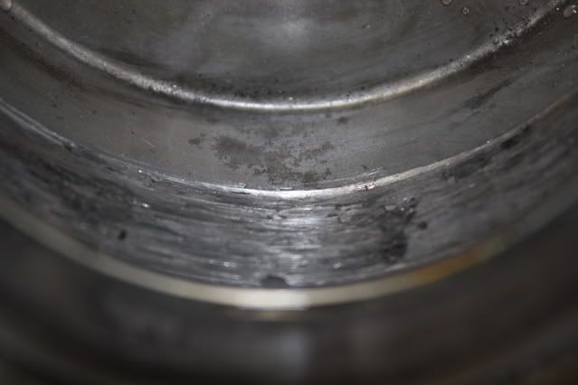

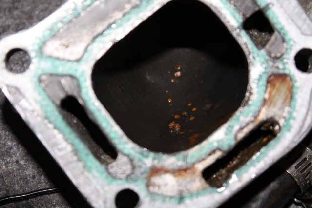

WELL...engine tear down is done.....rod is bent.:crutches:

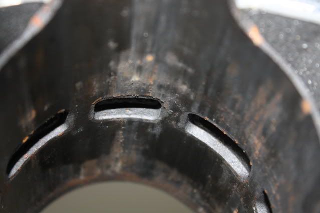

was welcomed with a suprise in my exhaust mani...BEARINGS!:smashfreakB:

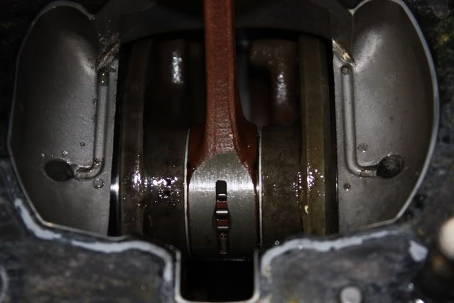

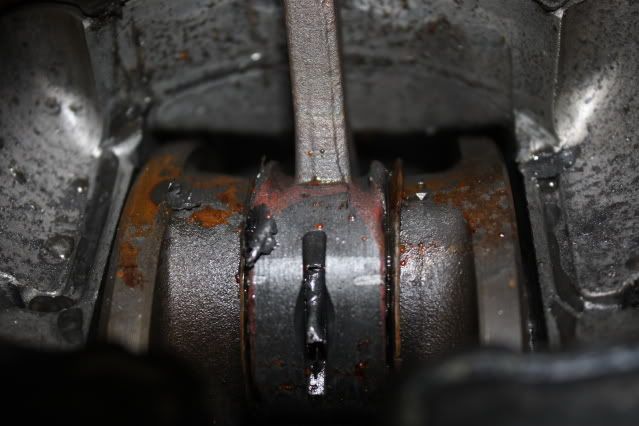

so the rod will barely move on the crank. this is what its supposed to look like.
this is what its NOT...

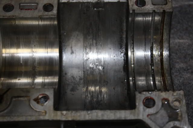

hope the bottom case is ok...

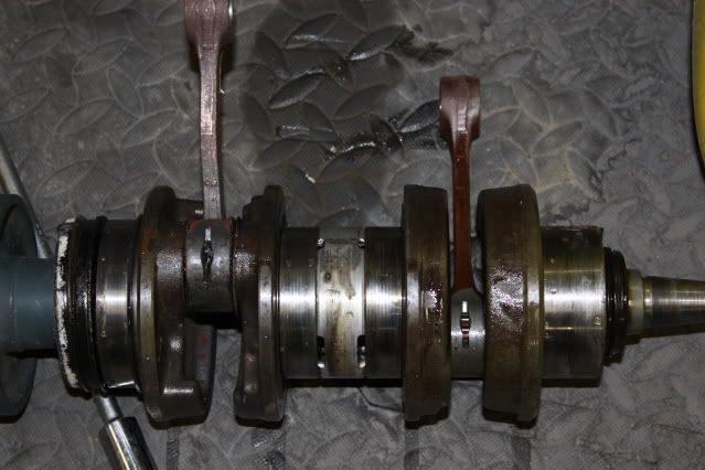

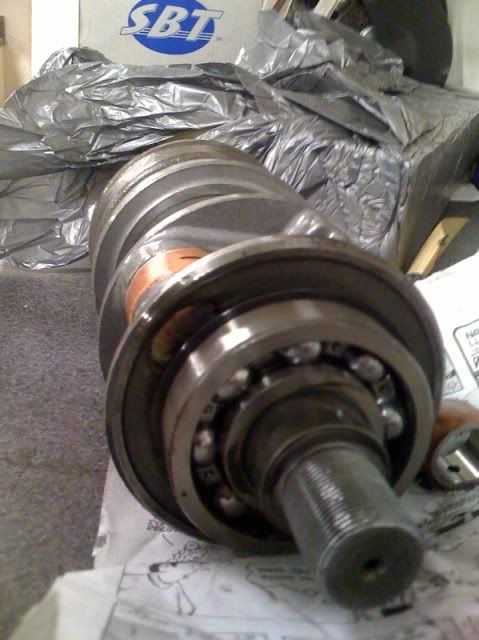

shot of the crank.
cylinder.

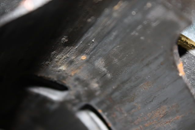

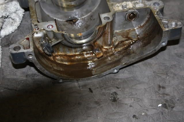

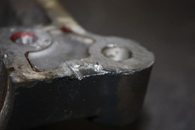

had a leak some where....

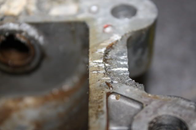

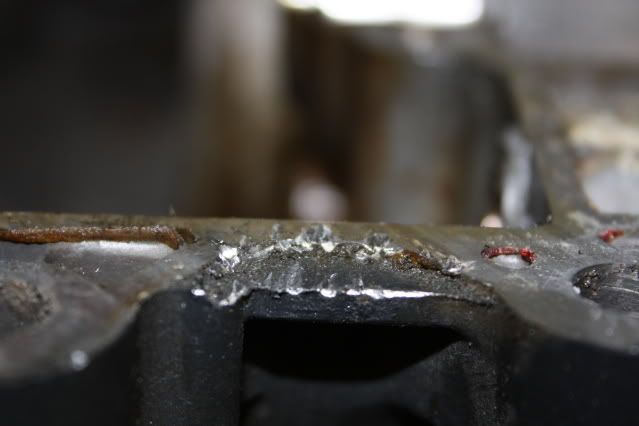

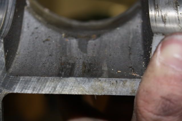

well if the cases were ok i think i just faucked them up......:dunce:
well.......time to spend money!:nutkick:
i wonder if i can get the cases re surfaced like a cylinder head?
oxnard111
Creative RE Purchasing
Where you pried it apart, those areas are in the flywheel cover area... those are not the mating surfaces that need to be super clean, so you're alright there. the imperative areas is the rectangular area around where the crank sits. The marks in the last picture still look to have enough sealable area to be ok.
But about the rod slapping the bottom, I do not know if that is re usable or not. Someone else will have to chime in.

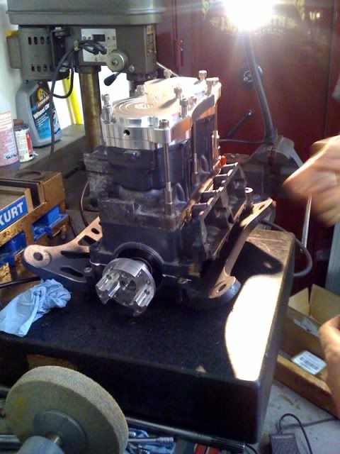

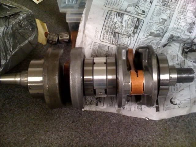

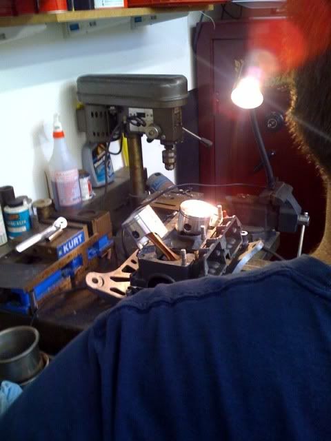

the motors back together again and is better than ever. Carl says with this package it should last for 500 hours. sounds a lot better than 8! (don't swamp the motor don't swamp the motor:fingersx:) its now equipped with:
a trued and welded SBT crank
Wiseco pistons .500 over bore
61x bored and honed cylinders with some cleaning up from Carl AKA Cold Fusion
Cold Fusion Kawi style billet couplers
Cold Fusion billet head with 35cc domes
Cold Fusion billet flywheel cover w/o-ring

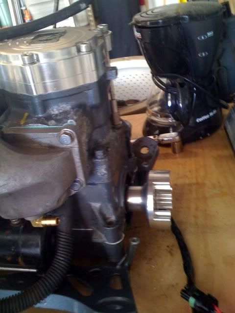

everything's ready but waiting on my electronics from #0. he lengthening my stator wires, bullet proofing my ebox, and rebuild/ rewiring my start/stop switch:bananajump:
pry be riding in 2 weeks! here's the pics.

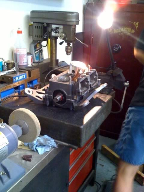

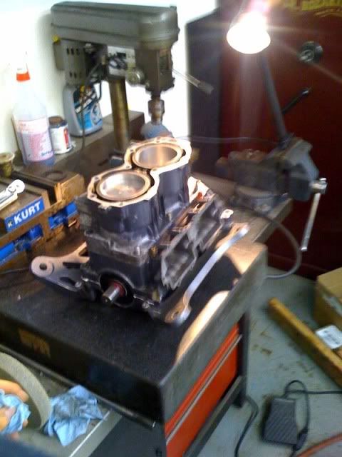

new crank
piston install
shiny.................
taa daa!:smile:

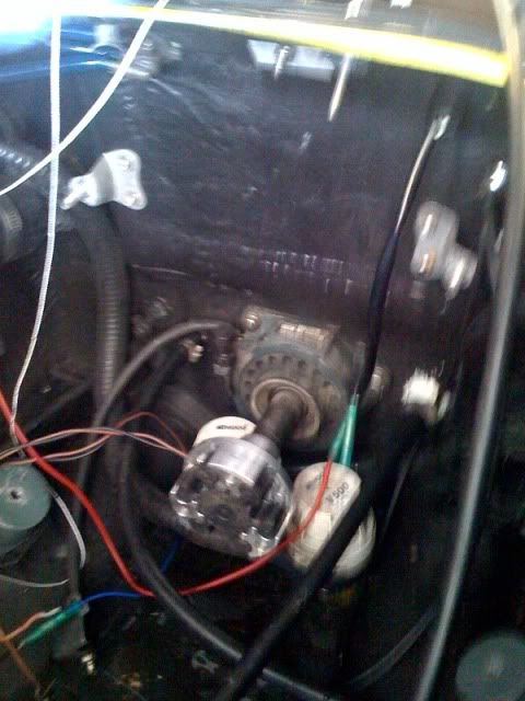

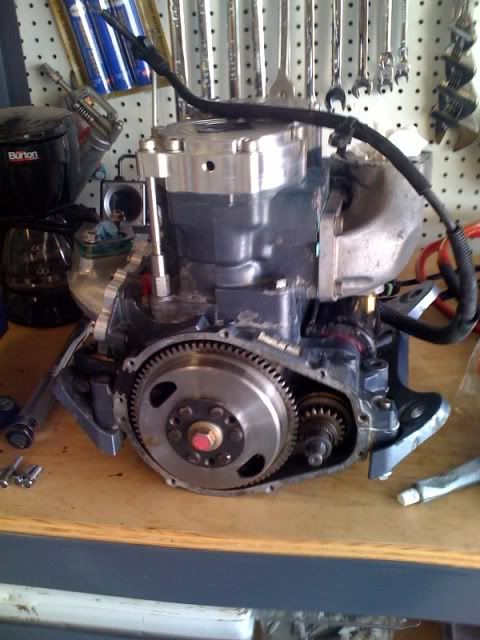

So Chris Geoff and i did a full assembly on sat and got every thing put back together!
started right up! was so stoked you have no idea!!!!
thanks again Chris and Geoff! i know, you dont have to tell me........ i work harder not smarter!hahahaa
heres some pics.
so went riding FINALLY and had a blast! was stoked to have Carl, Chris, and Geoff out there not only to ride with but to have if something went wrong. added bonus was brett and his wife out from pismo and chad and andrew to watch and get stoked on there shredability.
i thought my motor ripped before, but now having every thing so fresh and tight, accompanied with the flow control valve, lightened flywheel, and carls couplers....this things got bottom end BALLS! Carl was saying the lightened flywheel with the couplers is like 1.4 shedded pounds, which is huge. the motor spins up alot quicker and is so fun to ride!

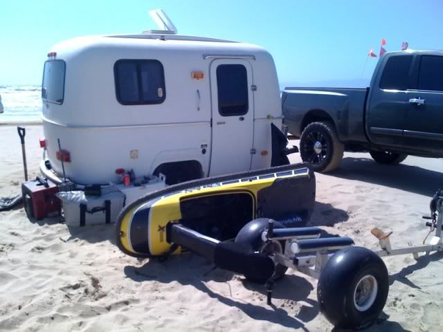

Than headed to Pismo for the Liquid Militia ride. rode friday and rode for 15 min AGAIN and blew my splines on my mid shaft and short shaft..... do i have bad luck at Pismo or what!

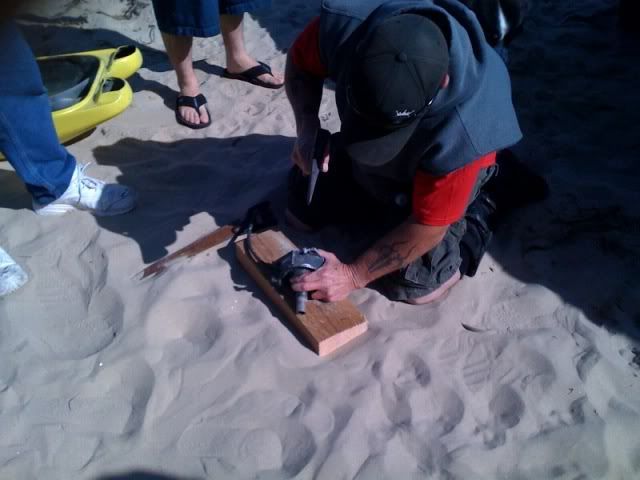

took apart everything in the sand and called up Taylor Curtis to see if he had a pump and midshaft. he was so cool, he pulled the parts of his other Rickter for me! so headed to TC Freeride to pick everything up and swap some things and was back on the beach.
threw everything together in the sand. realized we didnt pull out the dowll pins (SP?) but my neighbor had that figured out with a hatchet.....hahaha!

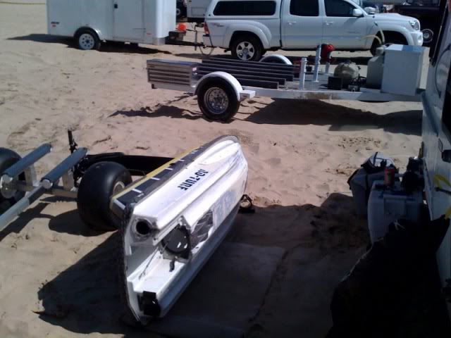

rode the next 2 days but seemed like i just kept loosing power.... heres some pics of Pismo.
Like my scupper? DUCT TAPE!
hatchet man!
