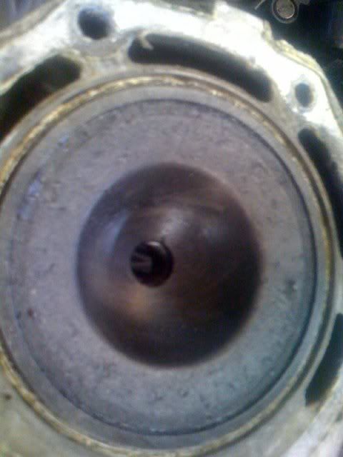

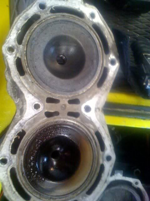

here's the pics of the damage.
heads toast.

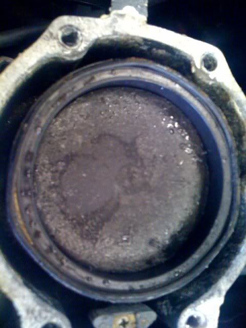

hmm that looks good, good color, its at TDC.....hows the other you ask?

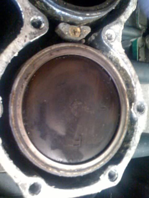

OMFG! TOAST!:17:
sooooooo......4 rides..... 1 at Pismo, rode great till i broke my pole and swamped my motor. 2nd at pismo, rode like doo doo at the end of the day. 3rd at ventura, rode like doodoo, after further inspection my e-box was half full of water and a ground was disconnected, fixed it so i could ride it for the 4th time..... felt great, got out of the harbor, did a couple WOT bursts, all was good, WOT 3 seconds BOOM.............:no: dead.....
this quest for a barrel roll is gettin pricey.
so what it looks like happened was a bearing went out on the crank which made its way to the rear piston. the motor will spin freely about 3/4 than the last 1/4 is stuck..... rear piston is done, it will not go TDC, sleeves feel good so it will only need a one over bore. Pro-tec head is bye bye.
i pray to god that when i pull the crank the cases aren't toast......
