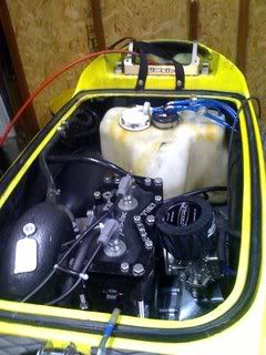

Zack and I got a ton done last night. The whole engine compartment is buttoned up with the exception of him turfing his tank so that the limited chamber doesn't rub on the gas tank. And he needs to tighten one hose clamp.
Just needs to slap on the turn nozzle, ride plate, handle pole and steering, and adjust the cables.

alright so over the weekend i turfed the side of the tank so it wont melt and got my fuel tank straps strapped.
wired the bilges so there good to go

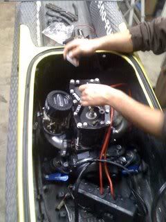

before i put the pole on i got excited and just had to hear the motor turn over. hooked it up and was greeted with a SQUEEEELEELEELEEELEEEEL while trying to start.......... ended up being a bad starter so i used my "parts ski".....robbed and replaced with a good one. man that was a biatch to swap the starter with out removing anything but i got it done.
so Geoff you owe me a starter :)
put the pole on but was tripping on how springy the Blowsion spring was....... the pole was just standing straight up!
got my grips, throttle, throttle cable, steering, start/stop, and chin-pad done.
tonight ill cut my ride-plate, hook up my primer bulb, attach steering nozzle, hook up my limiting rope, and hopefully figure something out for my tubbies this week.

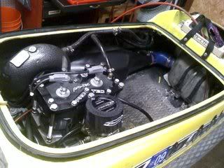

ok so.....ITS ALIVE! ALIVE I TELL YOU! BRAAAAPPAAPAPAPAPAAA!:highhorse:
so 2 days ago i tried to start it and it was having massive backfires and would onlly wanna start by dumping gas in the carb and WOT.
we went thru all the tests and came to the conclusion that either the MSD is wired wrong. so we swapped it out with my Pro-tec from my blue ski and it instantly fired! thank god.......
so i swaped my ride plate with the shorter R&D i have cuz i didnt have time to cut the other.
threw some bostic on the front of the tubbies so it will be a little protected until i find time to glass them in.
and yep.........PISMO HERE I COME:usa:
