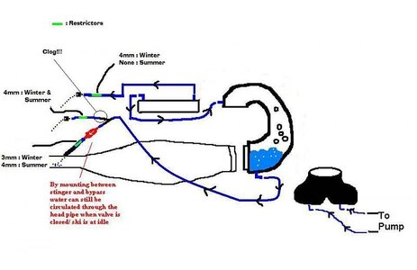

Well after taking more hoses off and inspecting them I found a major clog.
It was in the T between the headpipe and stinger. The only part of the T that was clogged was the part that went to the bypass. The part of the T that went to the stinger was fine so the stinger was getting water.
I guess this could explain why my headpipe heated up and caused the hose that was connected to it from the cylinder head to melt and pop off.
See picture below:
See picture below:
bzzzzzzzzzzzzz. eh, nope!!!!!!!!!!!
if that was the case, all the water would have just passed into the stinger, may have loaded the waterbox more but not gonna contribute to the overheating...........

but with a 3mil restrictor and FCV before the stinger it definitely would have restricted the flow more causing it to heat up and weaken the hose.

thought it was a 4mm restrictor, but either way, dont think that would be the cause, but who knows at this point unless you want to fix the hoses, run it again and see what happens. also, if you cooling line from your head to pipe comes off, the hot gasses from the pipe can work back into the hoses at the stinger fitting, heating them up also since no water is being injected at that point!
Yeah I'm definitely replacing all of the hoses. As long as I can keep them clear I shouldn't have a problem with cooling.

I'm running a 3 mil between the FCV and Stinger and 4mils on the bypass for Winter
and
then I'll run a 4 mil on the bypass from the T, no restrictor on the bypass from the head and a 4mil between the FCV and stinger in the summer.
I figure thats a pretty good starting point. A friend of mine (#0) actually designed a T fitting with a digital temperature sensor that fits into each of the pissers and transmits the data to a guage so you can determine what kind of temps you are running out of each of your pissers. It's pretty cool.
