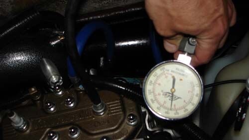

Last night I checked my cylinder pressures, engine cold, with the throttle wide open, other plug still in. I had 140 lbs front and 135 lbs rear. I tried to check squish, but the solder I had was .062 thick and did not make contact with the piston at all. I have to get some thicker solder and try again.

Ragged Edge Racing said:Man, that is low. Without reading this entire thread again, is your ski ported at all? Most SXR's are about 160-170lbs. Double check with someone else's gauge. What's it read warm?
