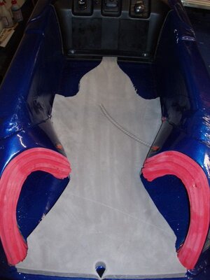

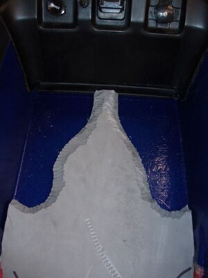

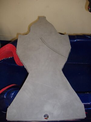

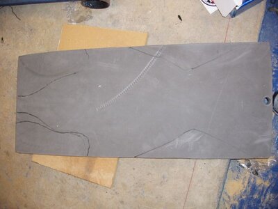

very nice build. just about to embark on the same project, but I doubt I will go as deep as you did. $$$$$ At least you showed me a few nice details I can do on the cheap. thanks. One bit of advice-glass that MDF or find some solid plastic like a cutting board or something. take a small scrap of that MDF and put a few drops of water on it an leave it for a week or so and it will look like a Chia Pet! found that out the hard way. It will swell also and then crumble and leave a mess in the hull. Other than that I love your "How to build an awesome ski thread".:hail:
