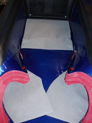

I received my 8 mil foam from Hydroturf and got to work chopping it up and putting it down in my recessed foot areas and test fitting it with the thicker pad layed over the top of it..

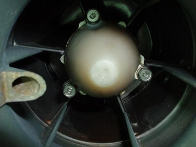

While the glue was drying, I bogarted my super-sweet WetWolf Freestyle Pump Cone from my other SuperJet and installed it on the new one.

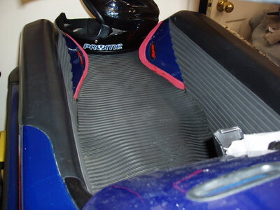

Here are some pics of the finished tray along with some of the stable.
