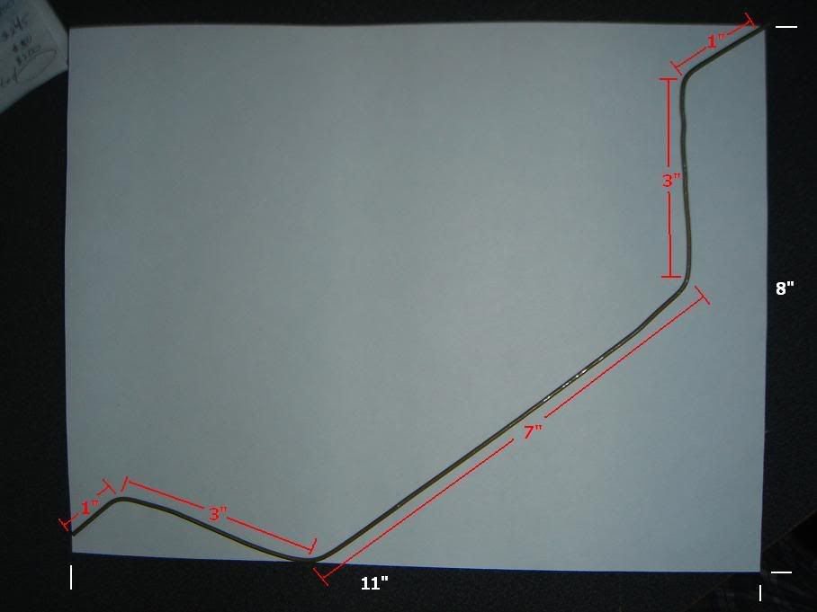

lol the bracket got more attention than anything else, i used a hanger to make the outline then bent the bracket that i got from home depot for like $3 ill put up the outline here in a little
here we go.. its best to use a hanger to make an outline because some jetskis might be a little different, once you got the wire just how you want it then take the bracket and go at it. my bracket is 1/4 off the hull, because after i attached the bilge bracket that are about 1/4 lower than the bracket, so right now both bilge pumps are flush with the floor.
