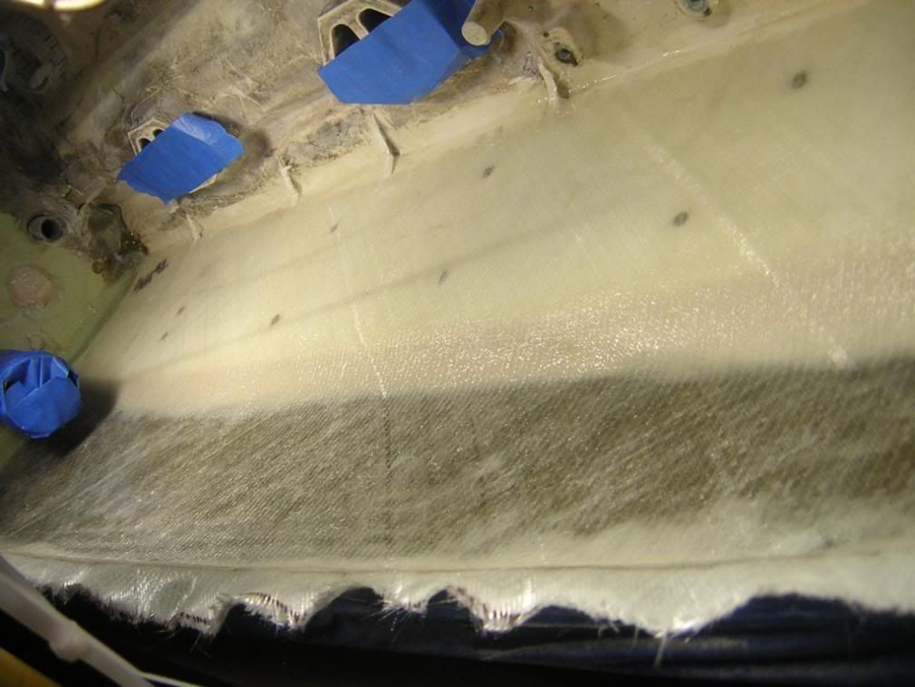

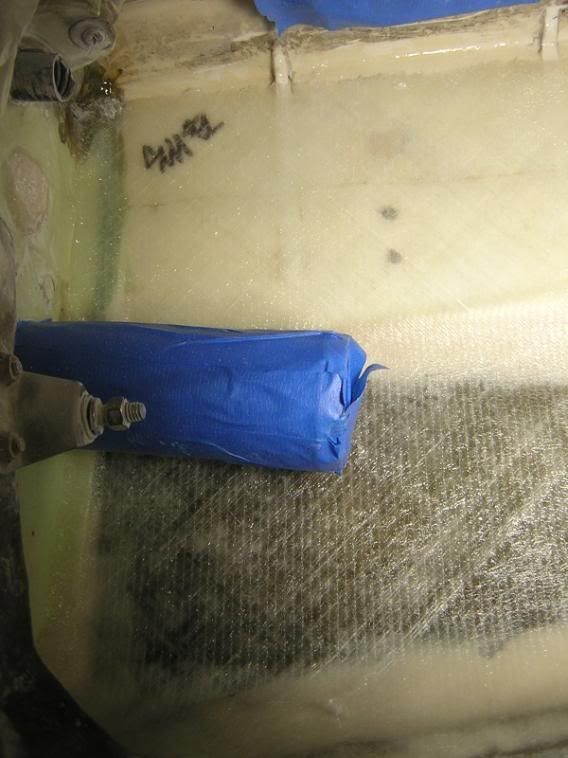

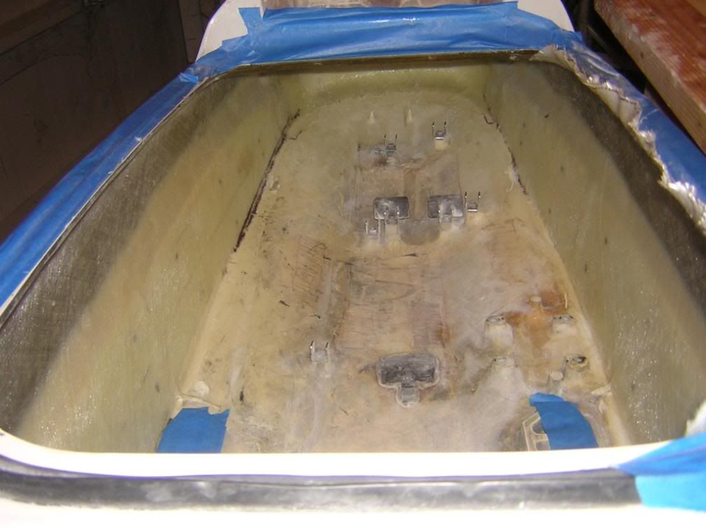

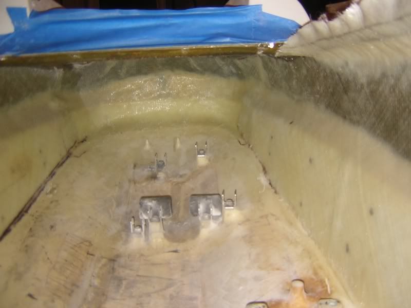

I ground all my plastic ziptie hangers off with a grinder and used a dremel with a little cutting wheel to cut off the water/fuel separator then cleaned up the leftover with a grinder... you have to make sure not to go too fast though or maybe you will get the rivet too hot and melt the hoodseal (not sure if this would really happen or not, but the rivets on mine where getting really hot and started smoking a little bit -assuming that was the rubber....)
I have new hangers that I am going to epoxy or 5200 up where the old ones where.... I am going to hang that fuel separator back up somehow too....
I had a brand new hoodseal... was not going to ruin a 100+ dollar seal...
