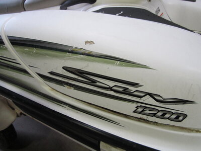

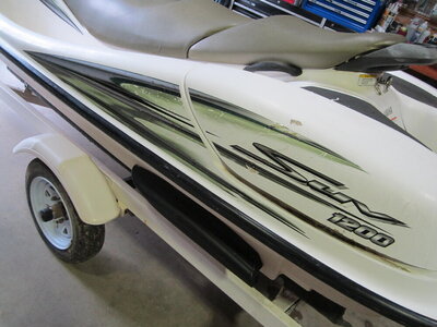

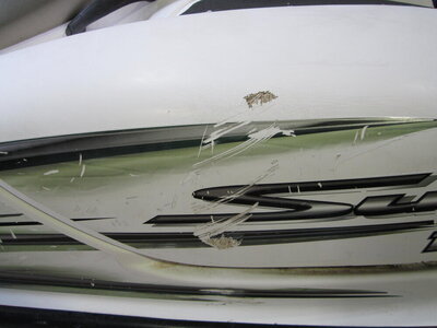

And since I'm NOT spending any money on decals...........some carefully placed Sharpie helps camoflage the dock rash. It's far from perfect but REALLY helps keep the eyes from zero-ing in on the damage.

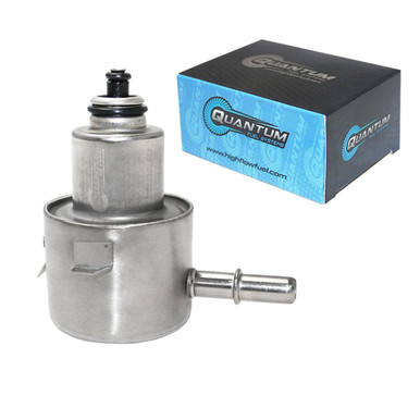

Back from the water test , it didn't go that well , it ran good for a few minutes then it started cutting back , to me it seemed to be running lean , I thought that maybe the voltage regulator was bad , I unplugged it , nothing happened , my best guess is that the fuel pressure regulator is partially clogged up , those have a paper filter element inside and when it's stopped up , that's it, I don't think I replaced it and one has been ordered already.
The fuel gauge is not working , but that is a pretty easy fix , I have several canisters around here for parts , the maint. warning and light is flashing , I do have the programmer for this as well as all the factory fuel pressure testing equipment that I will install next time I run the ski.
The last one I ran across like this it was a fuel pressure regulator that was the culprit .
I may borrow the regulator off the other ski and go run it again, right now we are in the middle of yet another thunderstorm.
You got a link or part number for that Bosch regulator? I needed one a while back and for the life of me couldn't find any notes on which one it was! I've had coils on the RFI act like that. Also had rusty metal bits stuck to the crank sensor do that too.

Here is the place I get mine from :
I am going to swap some stuff out and try again , probably not today though , it's still raining here , I have several spare coils , I will take one with me .
I get the pumps for the RFI's and 4TECS from Carquest they fit some year of Mercury Capri, I have the numbers here somewhere , they also have the filters and best of all they always have them in stock.
