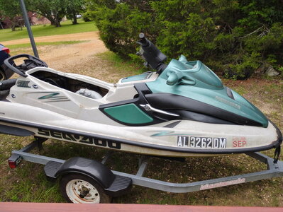

I put gas and a hot battery in the Green machine and it busted right off , but I noticed something weird going on with the plug wires , they seemed too short, so I pulled the other seat base that the coil is attached to off the other unit and tried it , same thing , weird , then I did a finger test on the front of the exhaust pipe, my finger would go in only to the base of my fingernail, on the other ski my whole finger slides in between the pipe and the hull, so somehow the engine in the Green ski is not set far enough back, I will loosen everything up and see how far back it will go , luckily you can get to all the bolts even the engine mount bolts are accessible , other than that no issues .

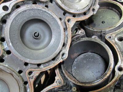

and another polaris 750 SL .... with a slight compression loss PTO cylinder ....
Opinions ....I really want to fix this one cheap so thinking about putting a used cylinder and matching piston on with new gaskets and then obviously new fuel lines clean out tank etc and carb rebuilds ......I know its a short cut which I normally don't take but kind of don't want to sink too much in the rebuild they just don't have a ton of re sale value here . Compression good on other 2 holes and I will run my camera inside to make sure no other visible damages.  Also there is a littl chunk of that piston missing ....is it stil down n the cases or ?IMG_8556.JPG

My opinion usually when that happens the crankshaft has been tweaked out of phase , if so you are only fixing the symptom , not the problem and it will do it again and again and again and again , I won't even touch one of those anymore.
like you said there is no market for those anymore.

I've seen a BUNCH of them hole the rear piston. Usually the triple fuel pump upgrade takes care of it. The single outlet was old and weak and that's EXACTLY what happens............ALWAYS the rear. It rarely ever hurts the cylinder. Hone, piston, a few gaskets, rebuild fuel system, and upgrade to triple outlet pump.........good to go!

You can quickly check the index on any triple crank with a dial indicator and a large vernier caliper , put the dial gauge in the center cylinder , spin it to find TDC, use the caliper to measure down to each piston, the measurements should be the same , if not it's out of index.
obviously that doesn't work for you since it's apart and has a hole in one, but you can check it once it's back together .

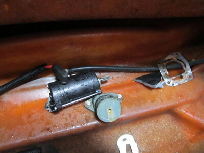

I loosened up all the engine mounting bolts , shoved a 2 x 4 in there and jacked the engine back as far as I could , it is back farther than it was and the measurements from the back of the PTO to the carbon ring and the back of the PTO to the thru hull fitting are identical with the other hull , the spark plug wires still do not reach .
I am thinking there is something different on this 3D motor than a regular RFI , IDK , what I do know is how to solve the issue, I am going to take some stainless steel or aluminum plate and make a bracket that bolts to the seat base , then the coil will bolt to the bracket , that way I can slide the coil forward to where it needs to go. I am also going to check to see if the GTI RFI LE coil I have has longer wires , if so I will just use it, same style coil and it bolts up the same as an RFI.
thx for all the advise... in this case I will go the cheap route, already have a new triple pump left over from another project.

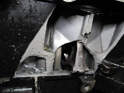

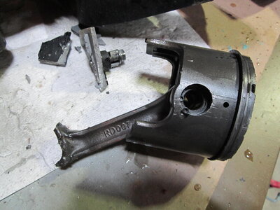

I had a spare minute today and cleaned all the algae off the SUV. Then I pulled it in the shop and yanked the 65u 1200. Good thing I bought another engine LOL!!
