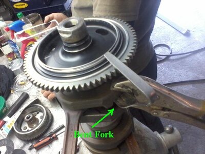

OK. not electronics. The flywheel broke. It is a Vilder Flywheel and the outer ring popped off. They are just EPOXY-ED on!! WTF....gonna drill and tap some holes into this ring and screw it back together and then zap weld the screws in place.
It also destroyed my pickup coil. DAMMIT!
