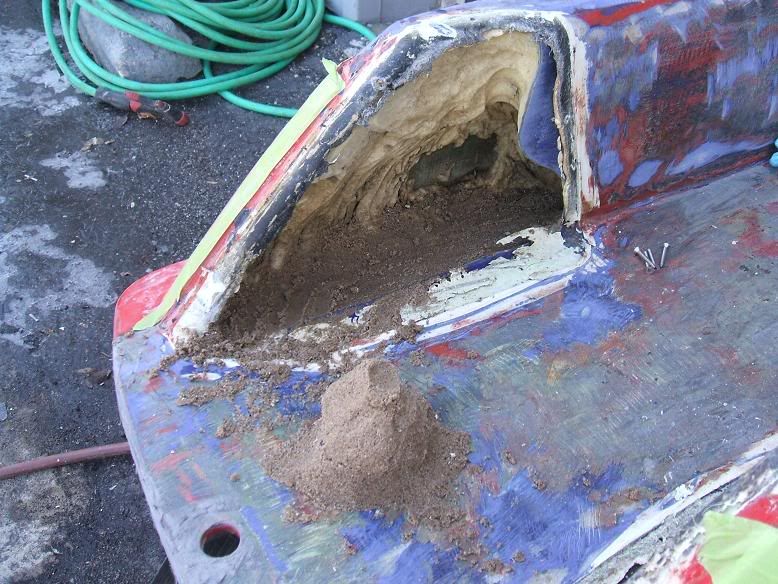

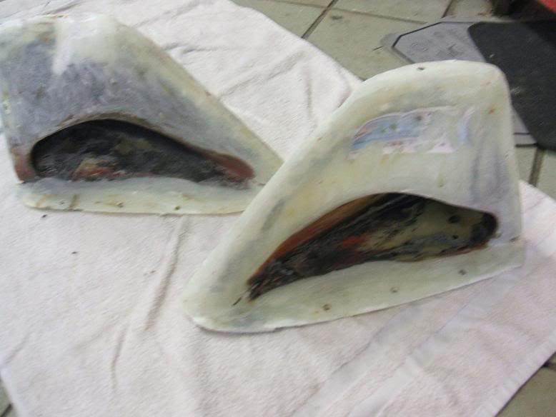

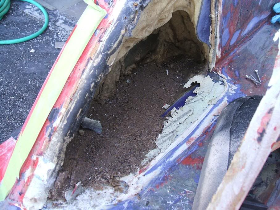

I just bought this ski from a friend last weekend 2002 SJ. It weighted out at 343lbs minus the battery with about 2 gallons of gas (maybe 12 lbs). After contemplating defoaming I took the turf off and found the footholds screwed in along with 5200, but NO glass and NO foam. So we began the defoaming process yesterday and this is what I found...SAND!
So I guess I got some 24-7 footholds ready for E-bay:nana:

But, I guess it proves that Maro's 24/7 footholds really were strong enough to not need foam to support them and give them strength like most of the others!!!!!!!!!

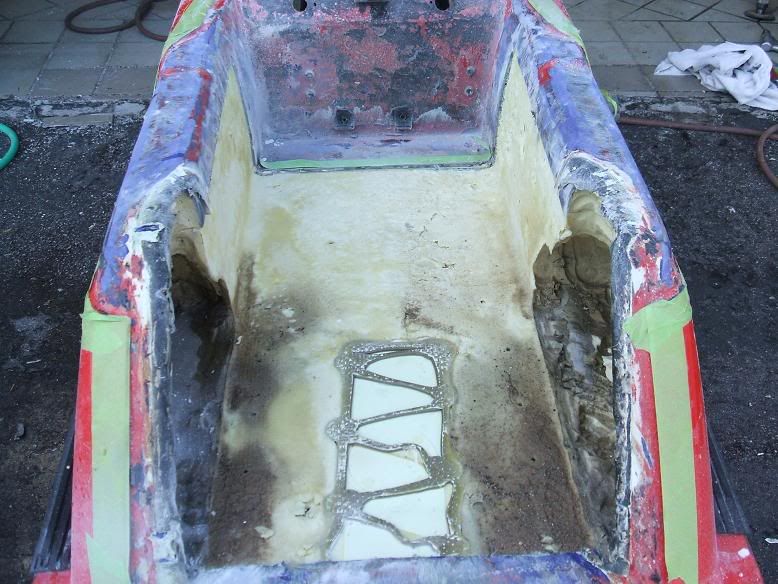

Wow man!! That thing is gonna feel like an aftermarket hull when you are done.
I haven't rode it yet, so I really won't be able to compare it to how it was, but I have been riding 2 non-stock hulls (my carbon XFT and a squarenose to round conversion). Can't wait to see how it compares!
