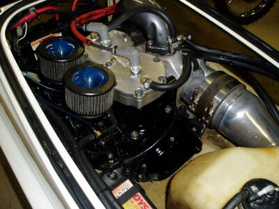

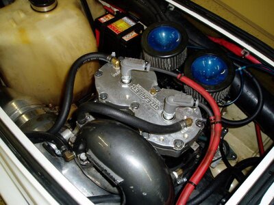

Here's the other pics and a run down of parts.
-Greater head (170psi), Coffman pipe, V-force reeds
-Water Dawg Diablo Hood and nose piece, hood hooks, hood latch, lowered pole bracket
-Foot holds with fresh turf
-Blowsion fuel cap, kick plate, bypass fittings, bow & stern bushings, bilge fitting, bilge pump bracket, carbon fiber chin pad, handle bar mounted bilge switch
-UMI bars and throttle lever
-Primer kit
-New stator, starter and bendix

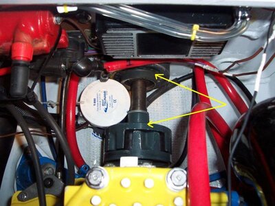

WDK is in Oregon. The midshaft is the short shaft inside the engine compartment that ties the motor to the pump. It will not be an issue finding one or buying one new from someone.
Someone correct me if I'm wrong but I think that was the only driveline change from square to round. Well that and the switch to dual carbs.
