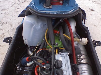

I used a bunch of silicone and goop to try to reduce the water in the hull, but the crappy hood seals on the X2 just let water in anyway.
The 1st picture is my attempt to use a milk jug to block the water out from the carb. It didn't work.

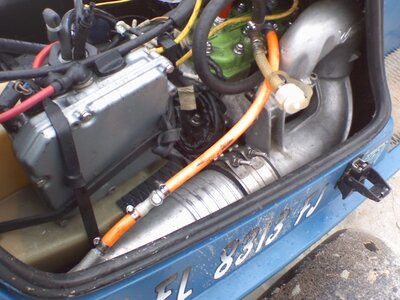

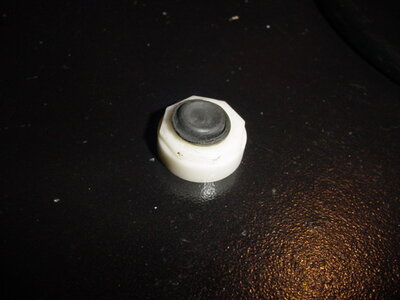

The second picture is Pete Jacob's flow restricter line from the 840 after the crank rod bent. ThANKS PETE!!! My pipe holds A LOT of water and I thought the combination of the water in the pipe and my laynard was a factor in the water ingestion problem. I don't think it provided a solution... but it did improve the bottom end.

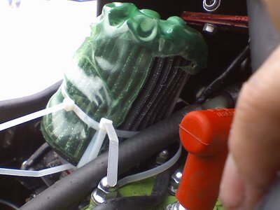

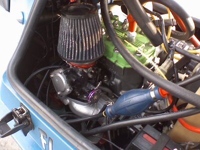

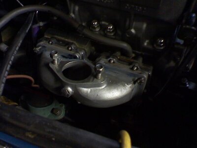

The 3rd picture was the fix to the problem, and still on the ski I might add. It is a 2-liter sprite bottle. I slit one side open about 3 inches wide and the full height of the flame arrestor. I held it on with zip ties, and used a propane torch provided by guess who... Tom... to shape the bottle arround the flame arrestor.
About 1pm on sunday, the X2 hit the water. I slashed the hell out of some waves and jumped a couple 6-8 footers 10-15' off the water. It was great. The X2 was rolled dozens of times after the sprite bottle was put on and I didn't get a drop of water in the engine.
It was great. I'm glad I was persitant and found a fit. The X2 is a blast. I didn't have a single problem the entire weekend except water ingestion.
PS. the pipe holds a LOT of water, and I believe wenching the nose onto the beach carts was a contributing factor to the water ingestion. I now turn my ski on the left side and rev it up to make sure there's not an excessive amount if water in the pipe before putting it on the kart.
