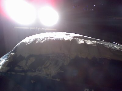

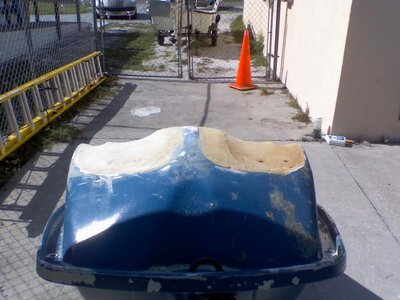

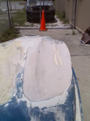

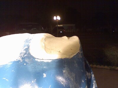

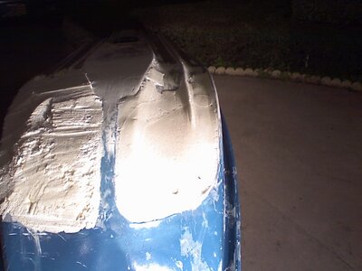

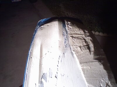

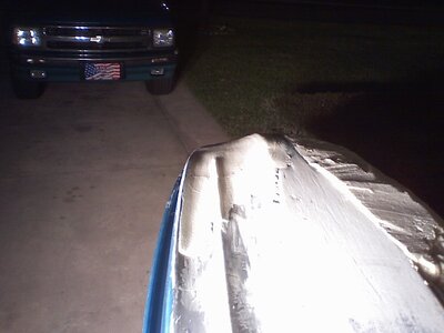

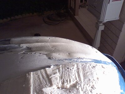

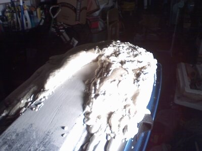

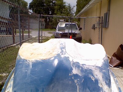

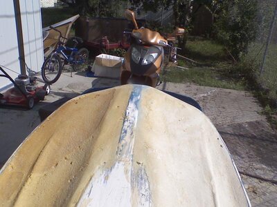

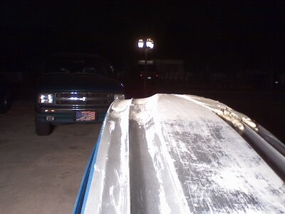

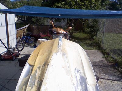

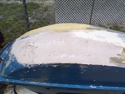

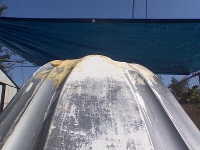

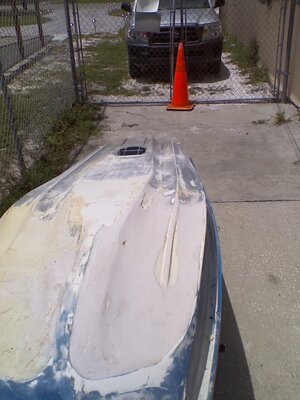

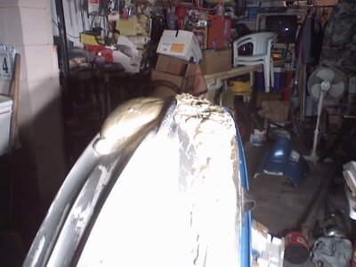

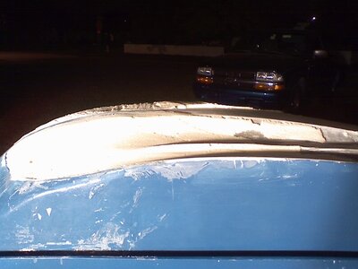

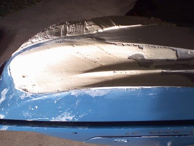

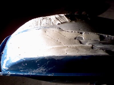

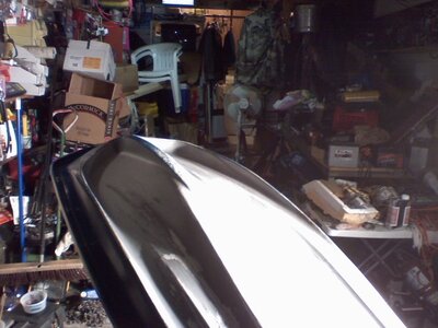

So I went back to my old ski and started working on the bottom. This was the 1st time I've ever used foam so I had a bit of a learning curve that wasted some time.

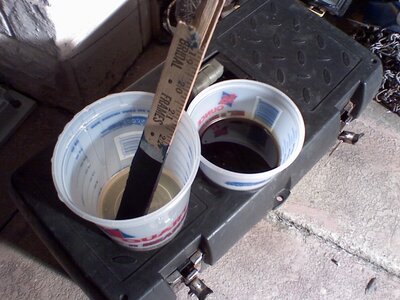

I used 2 about a quart of 2 pound foam (a pint of each part) with some obvious waste from that whole learning curve thing. It was about 50 degress out and I mixed anywhere from 100 - 300 ml of mix at a time.
Things I learned about foam...

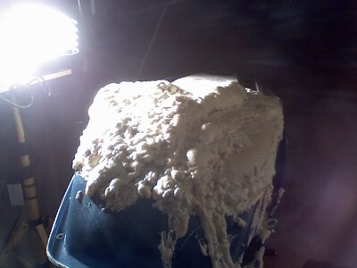

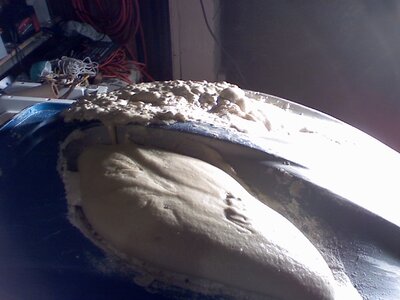

- Foam has a lot more viscosity than I thought it did. It's very runny before it starts to expand. I have a very unlevel surface and it made it more difficult than it needed to be
- YOu can 'pop' the foam if you mess with it before it dries. Once it starts expanding, let it expand. If you mess with it, it pops and gets very dense, so not a lot of expanding occurs. Pour it in the cracks, let it do it's magic and leave it alone.
