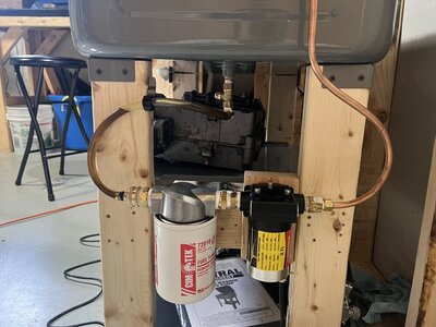

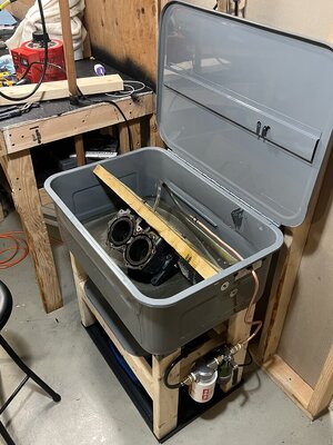

My home made honing bench uses a harbor freight parts washer tub (every other part besides the tub itself is trashed). I plumbed in a shut off valve to the bottom, using 3/8 lines into an oil filter. The motor is from amazon, and is meant for fuel transfers (it's a gear pump).
I run copper line to the top so i can route it where i want. I did have to make a block off plate for the tub's previous wiring hole. I also used a grommet to seal the hole. I use 3/8 line so i can stick the outlet wherever i need using copper clamps that i made with some left over coper pipe.
I fastened a 2x8 in the tub at an angle and drilled holes to mount the cylinder via the exhaust manifold holes.
I use a Sunnen AN-815 hone on a 10a drill plugged into a transformer so i can set the max rpm (no i do not know the actual rpm) . I move in/out by hand. The oil flows very well. I have had good results so far... call me crazy, but i went three sizes up with this bad boy. Yes it took forever.
