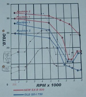

go the inferno if you can seal the elec box propally you will have no problems with salt water issues and the advantages of a couple of curves i am going to put one in my ski as soon as my cash flow builds up

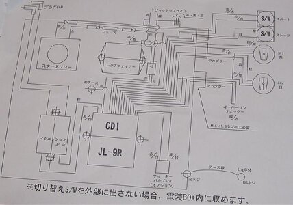

They have sent basic details on curves, will post later.

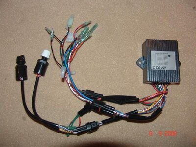

Trying to get english manual as all in Japanese, or will try find someone to translate.It has an LED on it, need to know what for.
The epoxy is clear so you can see all the circuitry.

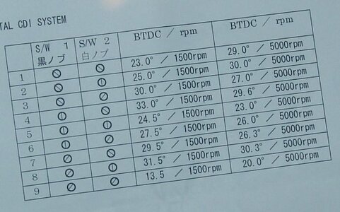

Which is switch 1 and which is switch 2?
One switch is white, the other black
The symbol that looks like a paintbrush, I think it means black.
