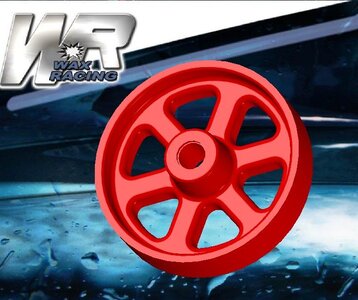

here is what i am working on
it will use a 760 front cover because it already has the digital front cover
and well the flywheel will look a bit like this
i like the way tbm took the centre section out to make it lighter and so i have used a simillar design
this system will work as a total loss
I have a wooden one but thats all so far
i am still trying to get some one to cut the ring gear
thats the hard part so far
My wife and i were talking and we have decided to buy a cnc mill ourselves as i am having trouble getting machine time
However i am just buying a house and that holding me up at the moment
The mill is about 2-3 mths away

:bigeyes2: :biggthumpup: keep us informed on your progress.
We have a gear cutter where I work? I dont now how much it would cost for something like that but get me a print and a quantity and i could find out.
