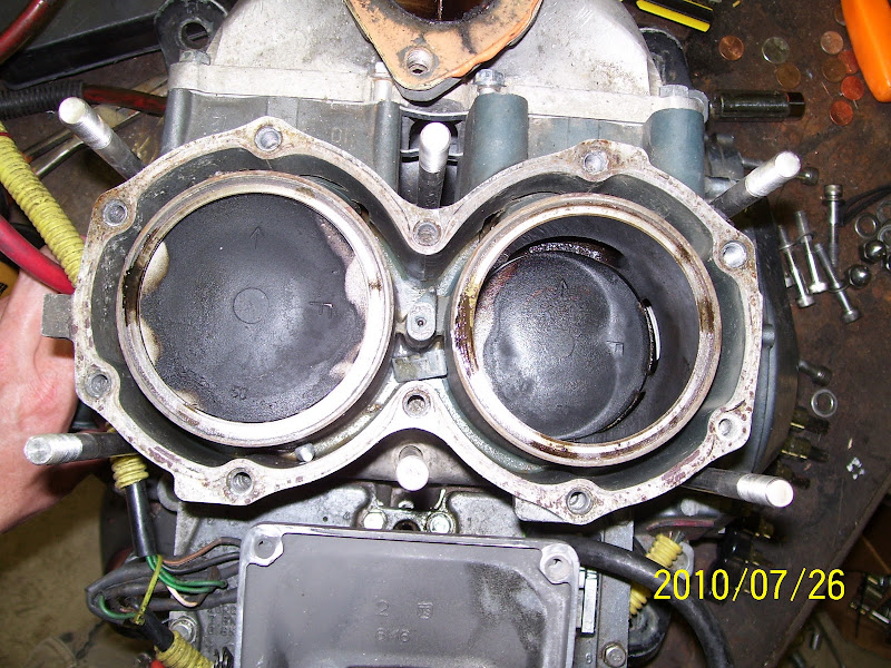

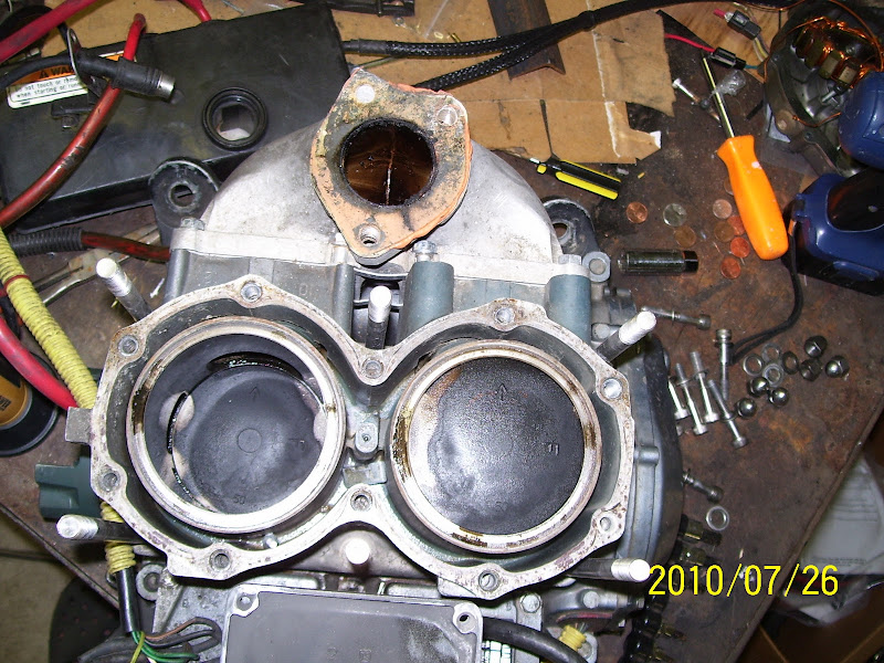

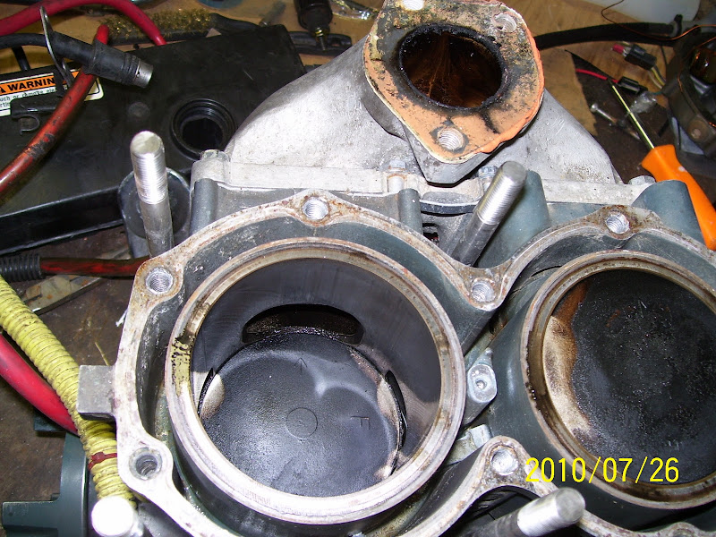

well hell.
I pulled the engine out, expecting to find a bad crank, or a hole in the bottom engine case.
Nothing I can find, piston wash looks good, everything turns and moves as it should.
so I removed the E box, got some rusty connectors, MAYBE the msd cdi is bad, or maybe it wasnt getting the proper pulse to time the ignition.
plan to clean those and try a few differetn cdi box to try and figure out what the hell is going on.

There's your problem right there - you got a bunch of change coming out of the engine.
Also, that stator doesn't seem to be right for the motor.
:haha:

haha, the stator is for one of my dual sport bikes...
there was some real slight pitting on the front dome, I guess I really shouldnt be running any 87 octane fuel.
the domes are 37cc too, I had always though they were 35.
whats the compression?
if you are anywhere near 175 or 180 your boat will run like ASS on 87 octane..
you bendix also spun when you initally hit the start button...I wouldnt count the front cover guts out yet
you know..I watched your fuel dump vid 3 times....it behaves EXACTLY as a surf boat does when it has water in the bottom of the crankcase.....you prime it, it stumbles but rewets the plugs......
trying flipping the boat completey upside down, turn the motor over by hand and see if any water comes out...

its an old worn out motor, it shows 150 psi in each hole with the ada head and 37cc domes, been like that for the few years ive been running this motor.
plugs arent wet.
bendix does that about 1 out of every 50 starts. front cover guts were all fine
Waterhawk, would would deglazing the cylinders gain me? it runs VERY strong like this ( for what it is)
