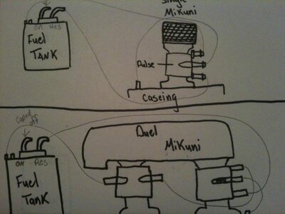

heres a diagram of my fuel lines. They top pic is for my sq and the other is my round
There is your problem, you cant supply the 2nd carb with the first carb, either put a tee in the fuel line before the carb or run each carb right off the tank, if you supply each carb off the tank you need to extend the "on" fuel pickup to the bottom of the tank line the "res" is
also your pulse lines need to be exactly the same length

Wrong, that is exactly how dual 38's are hooked up.
Pulse lines do not need to be exactly the same length, either. Besides, there is only one pulse line in that dual setup he posted.

My bad didnt realize stock 38's
