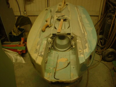

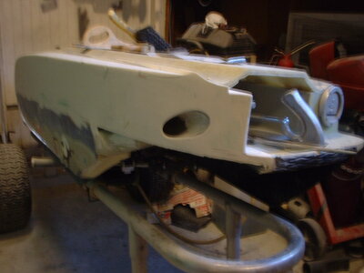

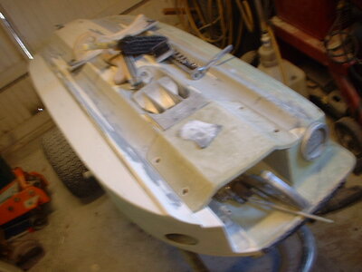

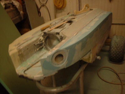

Got the exhaust tube glassed in. Lots of shaping to get the rail where I liked finished with a skim of filler. Leached some glass from Flash's resin lab which was kindly delivered by Wavehog(i love you guys):grouphug:
Glassed up the rail & the bottom using 4 layers 4oz glass & 1 layer 8oz twill. 2 layers 8oz on the sides. 1 week 1 rail. On to the other side....
