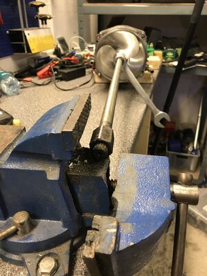

So now i took a 1.5meter pipe over the wrench and pulled. BANG - i thought impeller came off. Well no, my vice broke and the driveshaft had bent a tad

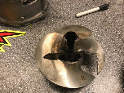

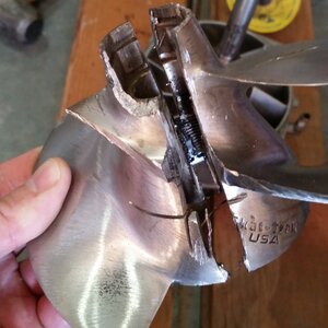

He tried more heat and couldn't it of either. So he ended up cutting my 18 hours old ST custom prop in pieces

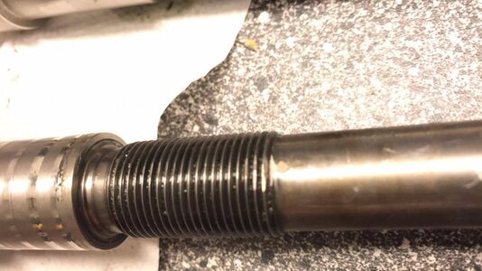

The shaft was bend a bit, but he saved it, and straighten it out, so thats pretty nice
Got the shaft within 2/10mm run out, at the splines of the shaft, while shaft is in the stator.
