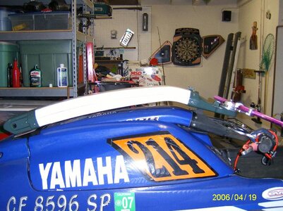

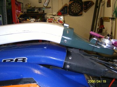

So I just ran into major problems also, and I haven't even tried the pole on my ski. I just got all my conversion parts from blowsion today. My buddy that has a SJ with stock pole was there. We got the UMI system on the pole. But tried to put on the chin pad (Blowsion Carbon Fiber) and it woudn't fit. Took off his stock chin pad and it would.
So we place my pole over his as in the pictures and saw the differnce. For one, the pole is about two inches shorter. Two, the whole top metal unit is different than his 98 SJ. Take a look at the picture, its not the greatest, but you can see the differnce. Remember how I said my steering stop was molded into the top unit?
So do you think my pole is from an FX-1? Seems like the only answer. This pole would be perfect for someone that wants to shorten their stock pole. I'm too short and the one inch that a stock SJ pole would be shorter would be perfect.
Anybody want to trade handle poles? Now I don't know what to do. Now just save up for another stock SJ pole, a UMI aluminum pole, or maybe and X-Metal.

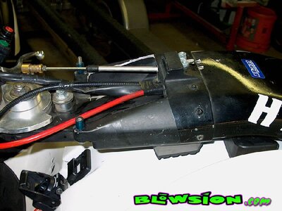

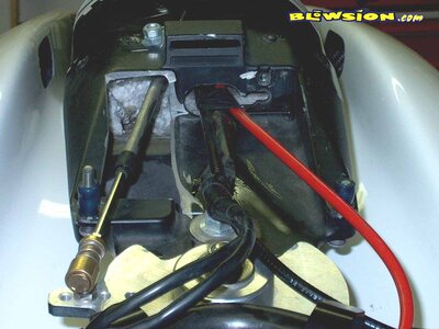

Pics if these help?
I am currently going threw the same conversion, after a so-called friend broke my stock pole, I talked to John at blowsion and he sent me some pics to help out. I hope they give you some insight on how to set yours up.

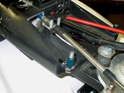

one more pic
This one shows how to secure it to the pole.
