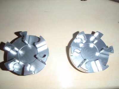

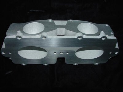

Sleeved BB motor 760 61x/64y going in my SN
One of the board members is doing all the machine work and porting work. Will let him chim in when ready if he wants to, I am am sure my words will not do his work justice and from the looks of it, its amazing and I can't wait to run it.
The platform is a 61x non ported cylinder and 64 Y cases.
All the porting and machine work is being done by him. We are using the NW bb sleeves for this build. I am using 84.5 Vertex pistons from Superjet 113. I am going with a Brand New ADA Girdled head with the 760 84mm 35 cc domes.
I am using a limited b pipe for the exhaust and dual 44's with the crossover filled and dual single oem flame arrestors.
I also picked up a grp K lightened flywheel for the 61x motor that will be used.
A new hotrods crank is also going into the build
All this to power my old 93 SN...

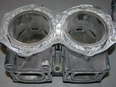

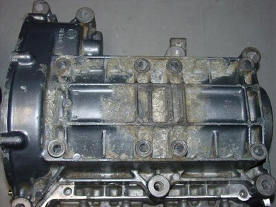

Here are some bigger pictures of the engine with a smaller font style.
Here are the before pictures of those crusty parts you sent.
