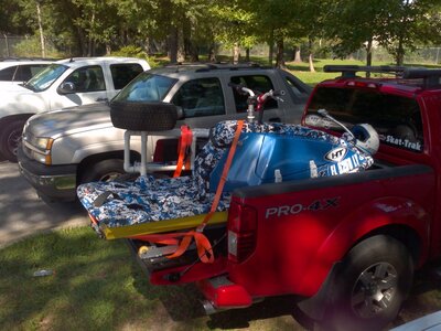

What about the differential vent? Doesn't the diff have a vent? When you back down that far how does it not fill w water?

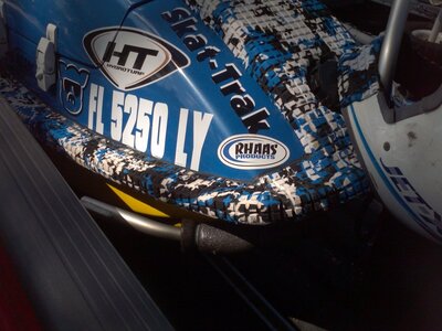

What is that blue ski?

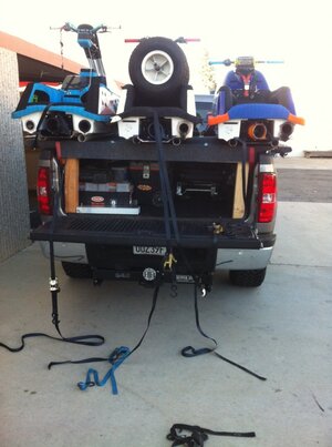

Super easy and cheap. Keeps skis from rocking around, gets them above my fifth wheel brackets, so no mat is needed.
I need to add some carpet but thought I'd share.
Lossingm gave me one of these when I picked up a hull from him. It was such a good idea, I made the other one to match.
Materials (per Stand):
13' of 2x4
wood screws, I used 20 2" screws per stand.
3' bunks x2
10.5" center x3
2' Bottom x2
