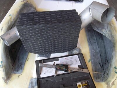

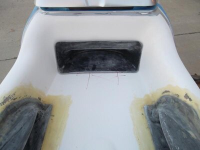

B-pipe coupler:
Chamfered the edge of the coupler(JM tip)..used some windex and mated the head pipe to the chamber. Made it secure with some hose clamps to let it set up for a few days and take shape.
View attachment 210958View attachment 210959
***RAD DUDE tube will not work on this ski with a stock tank, xmetal water box...Will be up for sale soon unless I figure something. I didn't weigh it but the tube seems lighter. Bummer.
