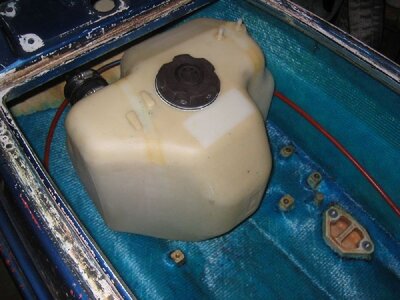

more pics
Metal4130
Eat, Sleep, Ride, Groove
Chicago
No, it isn't the whole pick-up assembly just the clunks. I bought the tygon fuel line from McMaster Carr and the clunks are from JSS and the stainless tube from my local hobby shop. Cost about 20.00 total.:biggrin:
The shorter one is for the main the longer one is for the reserve and my return and vent are the stock fittings on the top.

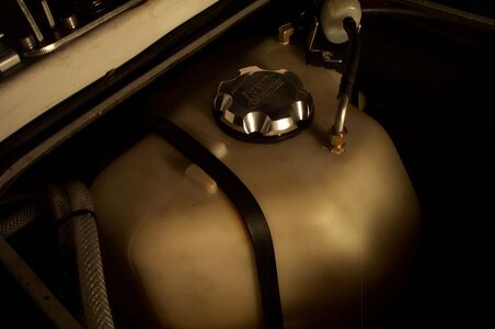

heres my new setup. i just put it together yesterday and installed it last night....
