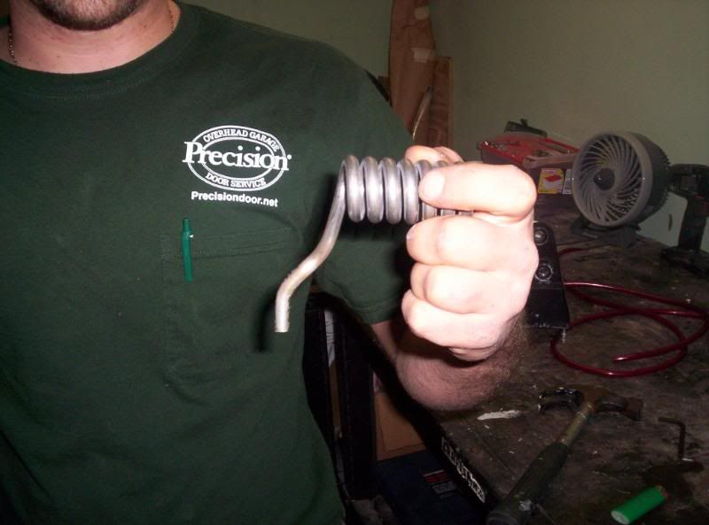

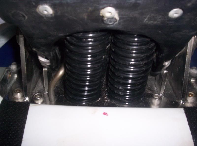

Just in case anyone is interested, we got a blowsion spring to work well in a dual breather x-metal lowered bracket. We bent the spring at the bottom so it reached a little further to the left. We put it in one of the bolt holes for the bracket. We then drilled a new hole to the left of the original hole for the bolt. The new angle of the spring made the pole basically stand straight up on its own.

my breather tubes were a little beat up so im going to get new ones but it looks like they will fit a bit ovaled but good. i will post pics tomarrow
