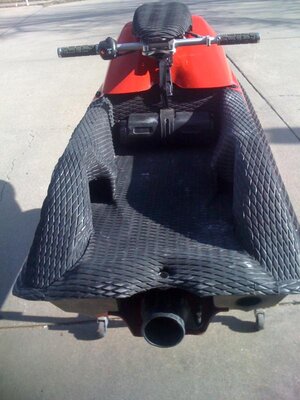

I love the REVs too. I modified mine so they are open behind your foot (making the back of the tray very wide) and then shaped the top of the foothold to curve over my foot rather than just be flat and create a pressure point. I where size 12s and they fit way better than any other hold I have tried. I wouldn't hesitate to put them in my next ski. That said I have never tried XFT holds and really like the way they look and they might be my next.
make custom enclosures out of padding and turf instead of using the glass ones, overpad everything and they are the bomb

Do either of you have build photo's you could share?
