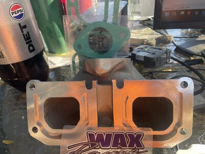

So, if I buy your Thruster Exhaust for a 62t, and your intake manifold for the 62t and your manifold plate adapters for 46mm dual carbs,
What jets and what popoff settings (etc?) should I request from HST?
Good point. i mean its the easier way if you dont want to machine. the bad thing is you are dropping the transfers down as well as the exhaust and thesea re already weak spots. I would be asking for a slightly thicker gasket than standard myself and machining more.Did anybody check with SUPERJET-113 to see if makes the 0.010 base gaskets?
Do you have an msd enhancer ?? if you do then sure. The zeel is a bolt in and it comes with the wax v3 in it@waxhead And because a Zeel would be too much for me to learn at this time, can I run the set up specified in post #39 with just a MSD Enhancer for now?
