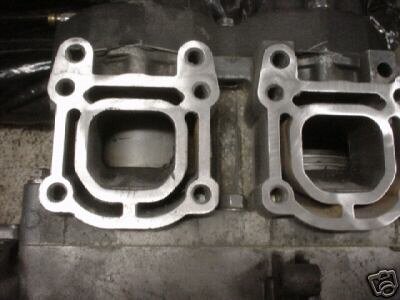

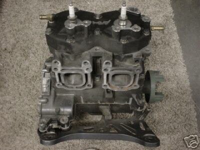

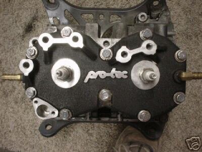

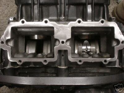

Yeah I love my 760. It was ported by Paul at LPW, has an msd enhancer, dual 44's, b mod pipe, ada girdled head, and it rips. I'll be puttin the lightened flywheel on before the season starts so that should help it rip even more. You wont be disappointed.
Ohio
No but I got some pix.
