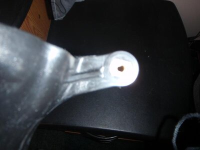

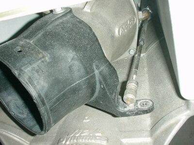

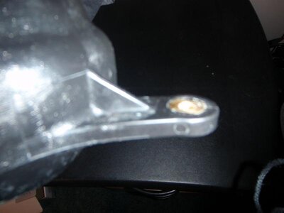

make sure the cable is not hitting the water inlet boss, I did this mod and bent two steering cables.
Also, you can use the outer hole on the XMetal turn plate, you may have to clearance the steering nozzle a bit.
This is if you are using the XMetal Pole.
1. When adjusting the Steering Cable do not connect the nozzle end of the cable until you have adjusted the steering end
2. Make sure the turn plate hits the Steering Stop in both directions
3. You may be required to cut 1/4” off the turn plate end of the cable
4. Once you have adjusted the steering end, connect the nozzle end.
5. Adjust the nozzle end of the cable to your desired setting
