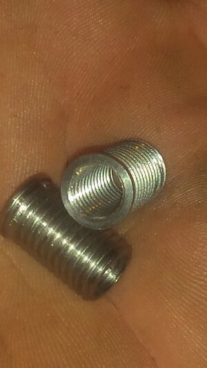

What size are you looking for? I have some laying around. I could help you out for the cost of postage.
Thanks Lumpy that would be killer. I'd use them and send it back. Maniac says M8 x 1.25 so I'll say that's what I need, lol. It's the threads for the exhaust manifold
