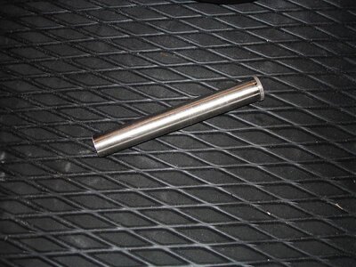

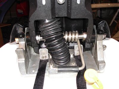

Ok, this was a PITA but I finally got the stainless tube machined, lasered out the washers and bolted on. If it lasts and works the way I want it to it will be awesome! It works prefect and should not loosen up at all.
