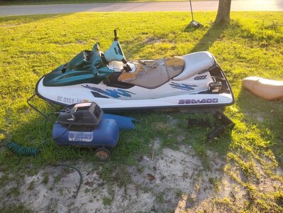

Front seat done and it is fabulous !
The trick on these is to stitch that rear piece in where it makes that funky angle , if you look closely at the rear of the seat you can see the stitching , you cannot pull that 30 degree angle without pulling the foam way out of shape .
Headed back out to do the rear seat after lunch , I didn't get to decide to pull it in one piece or not , the vinyl decided for me , I don't have a big enough piece of vinyl for a one piece so three piece stitched it is , it's really 6 of one or a half dozen of the other , it's just two straight stitches and two top stitches , no biggie , the one piece seat is much harder to pull and get all the wrinkles out , the stitched seat is much easier to install and make it look right , so stitched it is .
