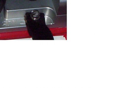

I have a piece of flat SS bar with a hold drilled through it to clamp it down tite, I just also ran it over the bolt as well so it can't come out. I also spread the fibers rather than drilling or cutting them so they won't loose strength.the attachment point at the pole bracket seems to be the weakest link.
is it just singed holes thru the poly?
or is there something stronger there I cant see?

How/where did you get the ss pieces that you put in the straps where they bolt on?

I like it!:djsmilie:Simple, strong, sanitary.
