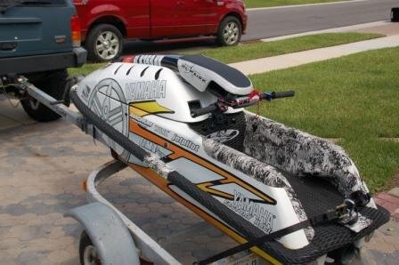

That sucks, you need a ratchet strap hood system.I happen to make them if you like i can set you up with one Give me a call or PM me E.J. 209 327 4499

ejs ratchet strap on my ski

Looks good stan just be sure and puller down tight and you wont loose her
and tighten after the strap gets wet. over that length it expands a good half inch.
also loosen it before it dries so its not super tight.
i got lucky, was able to use the same straps from my blowsion strap kit so i didnt need to pull the tank or nothing. i used the hole in the back of the strap and used a old bolt from the honda.

How well does the strap hold the hood laterally? It seems a hood latch would offer a bit (not a ton) of support from the hood being knocked off sideways say coming down from a under/over roated roll.

I agree with stan that you need to re tighten it once the strap gets wet.
On side ways impacts my hood stays on good with an OEM hood seal. I think some of it has to do with having the strip of turf running the entire length of my hood. I had a machine shop drill and tap two holes to attach a footman's loop to the handpole bracket. On thinner based brackets like the x-metal I imagine you could just dill right through the bracket and through the ski and use a nut and bolt system.
