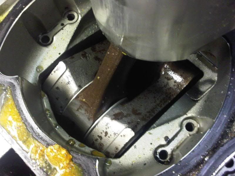

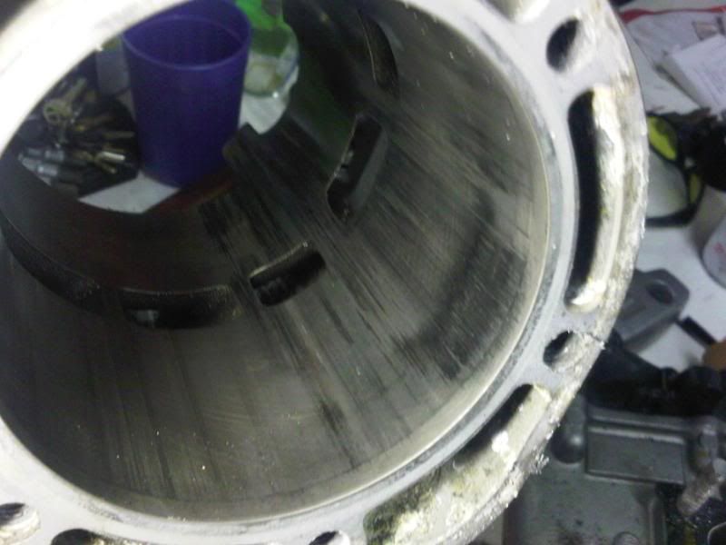

I was planning on checking compression when we met, but didn't think to bring an extra battery since he (crazyass911) told me he just got done riding it 3 weeks prior as well as he had his "tuner" make sure the ski was dialed in a week prior to that. I just assumed the battery was good to go in it. I guess not, battery is deader than a door nail when we meet, he assured me that its running perfect, and that he just rode it and his guy went through everything etc...so, long story short I trusted him since I had been talking with him about this deal for so long. I get the ski back, and check compression. 160psi in cylinder #1, 175psi in cylinder #2. Sean said it was dead on 205psi last time he rode it. Granted sea level changes PSI numbers, but this is obviously a different situation with the numbers being so far off.

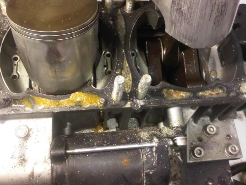

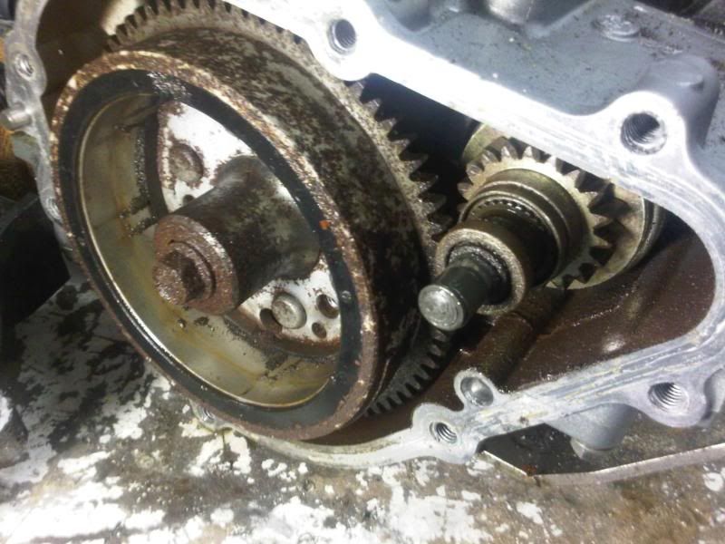

Decide to pull the front cover....RUST! and water pours out as we start to take the cover off.
Pull the domes---pitted from what I would guess would be the ring shavings?

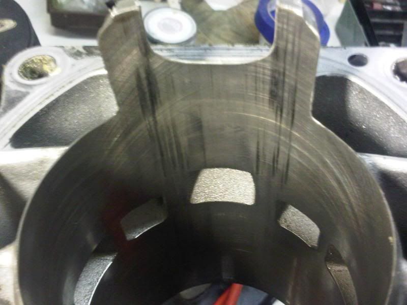

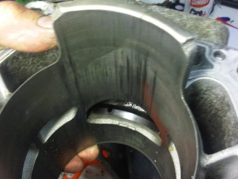

Pull the cylinders off----scored from the pistons

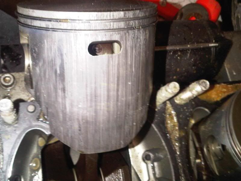

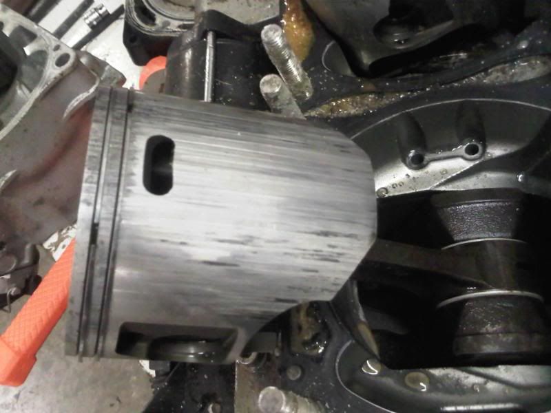

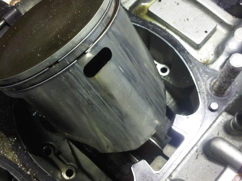

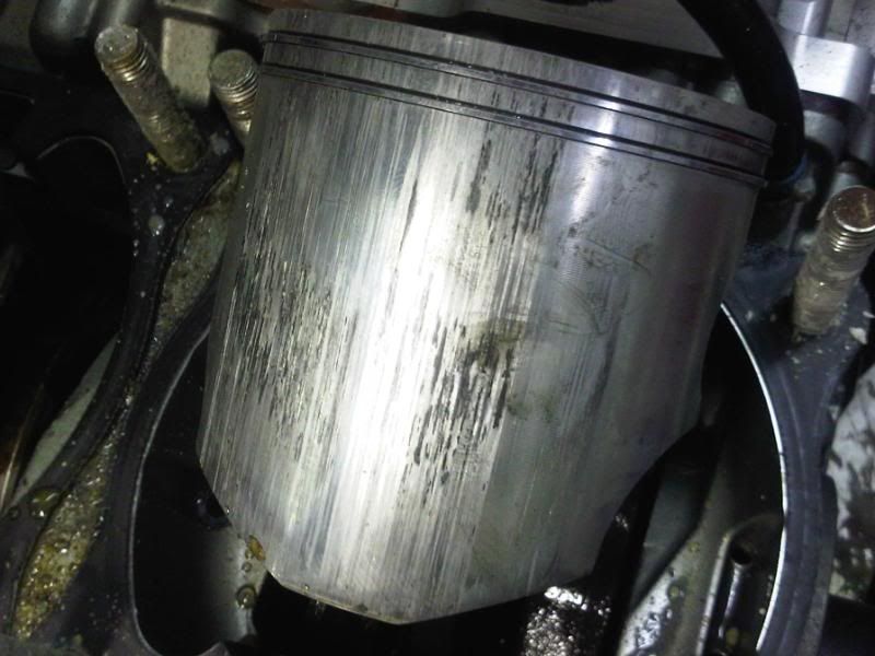

Pull the pistons-----royally F'd up!

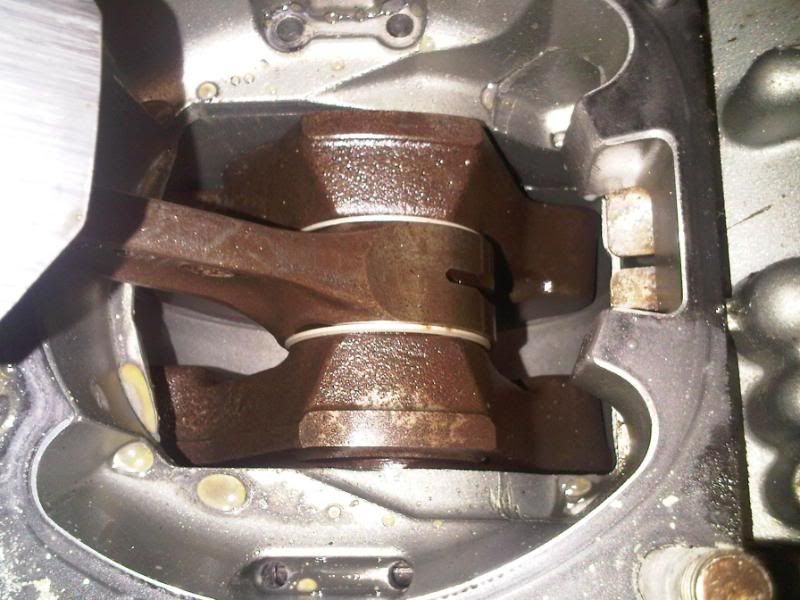

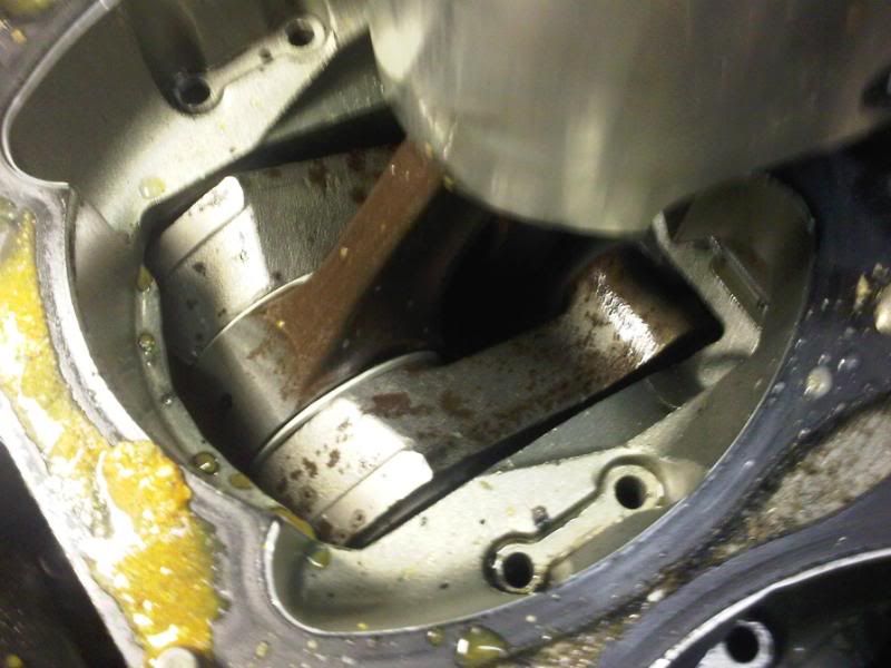

Crank is rusted, as well as the crank bearings down in the case.
