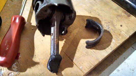

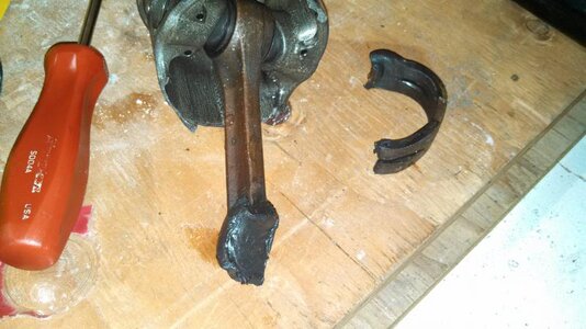

*update* new pics!!
IMG_20130827_191001_508.jpgIMG_20130827_191010_342.jpgIMG_20130827_191027_597.jpgIMG_20130827_191036_781.jpgIMG_20130827_191051_904.jpg

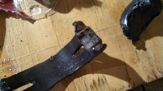

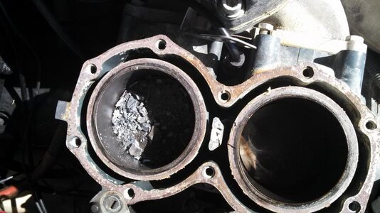

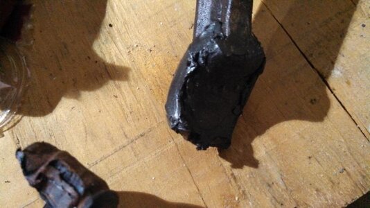

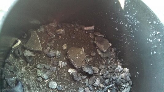

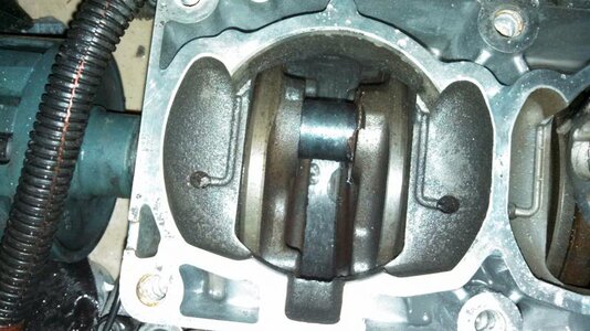

Honestly, the cylinders aren't in bad shape at all! The cylinder that the piston skirt broke didn't really even get scored.
Well I'd say my crank is pretty much shot LOL. That thing must have gotten pretty dang hot!! Melted it right off..

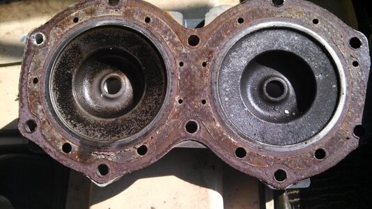

I can't believe it though. After 18 years, do motors sometimes just go? I dunno exactly what happened. I will know more once I tear it completely apart. Those are just pics of me taking the head off on the lift. I had to see how bad it was.

I don't know how bad it is, I'm pretty sure my crank went too. The case was hot enough to burn you, maybe a crank bearing went and overheated my rear piston.

I updated the first post with some new carnage!
Yeah my crank is toast for sure!! That's all the damage I've seen so far, I'll know more once I completely tear it down.

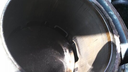

Here's some pics of the cylinders, they're not bad!
The Cylinder that the piston skirt broke in didn't even get damaged really.. I believe that's the middle picture
Wow man... The crank makes it so much worse sorry... If you were to go the route of attempting rebuilding this and using that cylinder you'd need a crank, head, pistons, gaskets, etc, and possibly a freash hone... you may end up spending more money than just replacing it. Personally I would sell that cylinder to some one looking to do a BB and use that money to buy another short block. good luck
