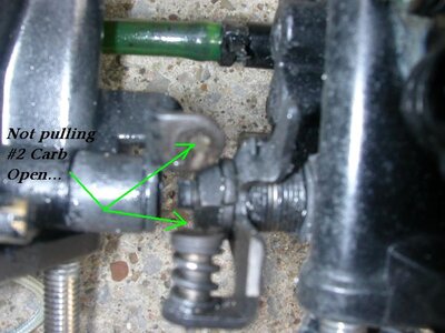

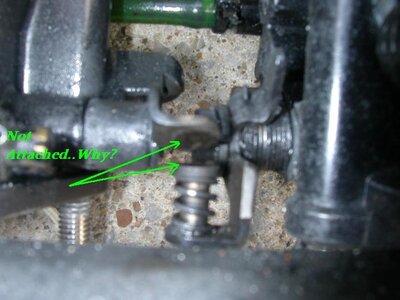

The linkage between my two carbs is broken...Not sure how to fix it. Anybody have any ideas?:AR15firing:When I pull the throttle it only opens the #1 Carb.... It looks like the pin inside the spring broke flush with the top part.

i broke the pin that holds the butterfly/ return spring clean in half..dont ask me how..i cased a reentry pretty hard but idk???

ya, looks like that little do-hicky broke off that holds that little flat tab when the linkage is engaged... not sure if you'll be able to fix it without some extra carb parts... I'm sure someone around here has some junked 38's you can scavenge some parts from.
I slammed a re-entry pretty hard too. My ribs still hurt... That could've been the one that did it...Me after the crash> :1244:
